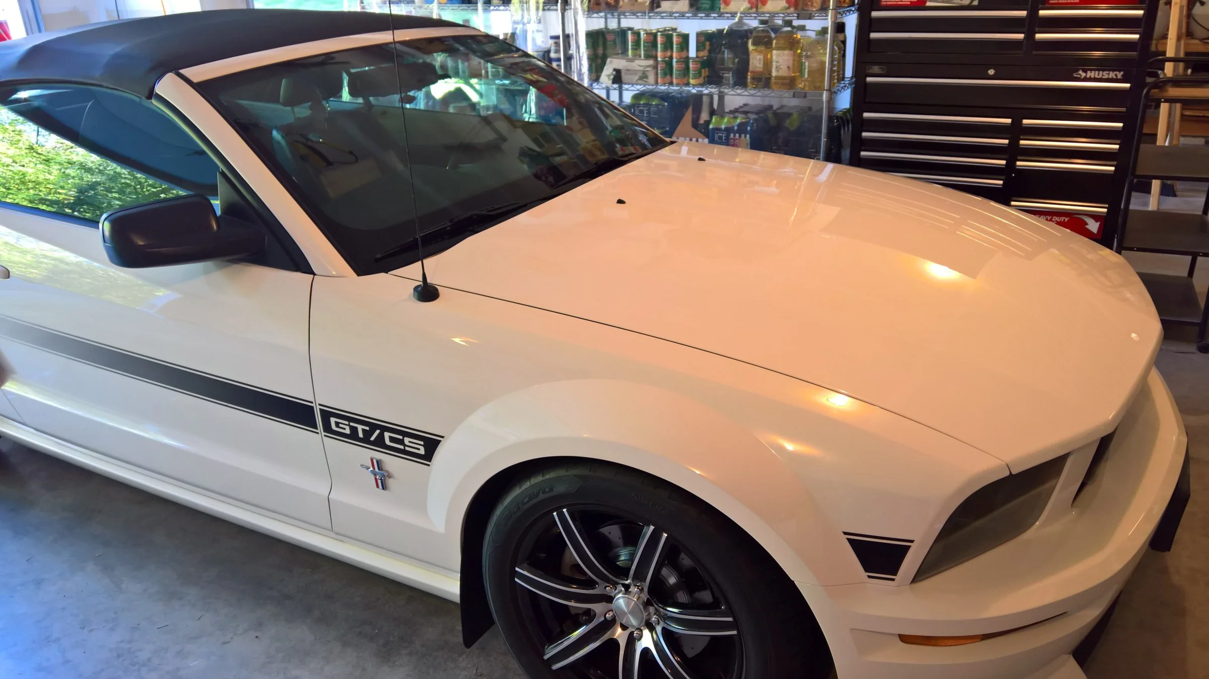

If you know anything about cerama coating you will hear the cries of "Its only good on new cars" or you "must have perfect paint". Only the second part is half true. I have done 2 vehicles myself now and its the best thing I ever did. Each in a different condition.
Now, for my 9 year old Mustang, the paint was very good but it had the typical swirls and imperfections you get after a certain amount of time. Nothing that jumped out because white HIDES a lot...but if you know what to look for....So I did it the right way
First - wash wash wash and degrease
Second - Clay bar to get off the contaminants that embed in your clear coat
third - I used Dr. colorchip on some small chips (very small) so that I had a good base
4th - completely rubbed the car down with alcohol to degrease
5th - Now here is the work - you need to prep your paint using the 3 step process of compound, polish and micro-polish. I used 3M 1,2, 3. There are other brands and big names but go with what the pro's use. I bought an inexpensive buffing wheel and 3 good pads of the right type (Red , yellow, black in that order) that go with the process
Don't worry about burning your paint. Keep moving, be gentle, watch a bunch of youtube videos. YOU CAN DO THIS. its work and this is why guys get $1500 to do your car with a $80 bottle of stuff. That part is the EASY part.
A cool thing about the process is the spots you did with Dr.Colorchip will blend pretty well...very hard to find.
Done polishing ? Great. Now wash and clean. Then when it has dried (by hand and then overnight) you AGAIN want to wipe the whole car down with alcohol. Now you are ready
apply your product in 2x2ft squares. Drying is just a few minutes and wipe that section smooth with microfiber towel. When done with the car, let it sit overnight. NOTE - YOU MUST DO THIS INDOORS !

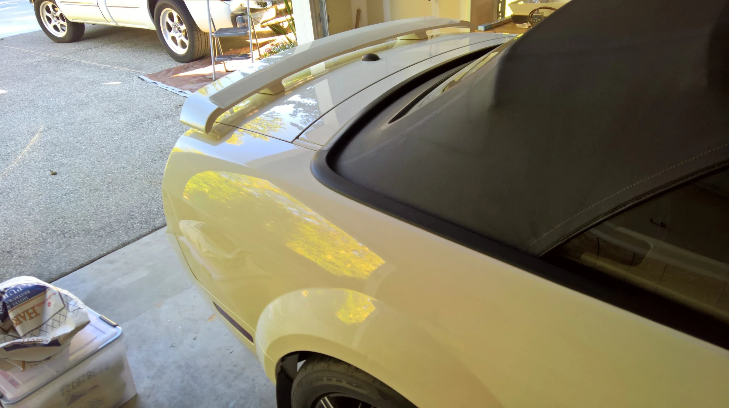

You are going to be amazed. Its like glass. Holds up. Water rolls off. Dust and dirt don't want to stick and every time you wash it, it looks freshly waxed.

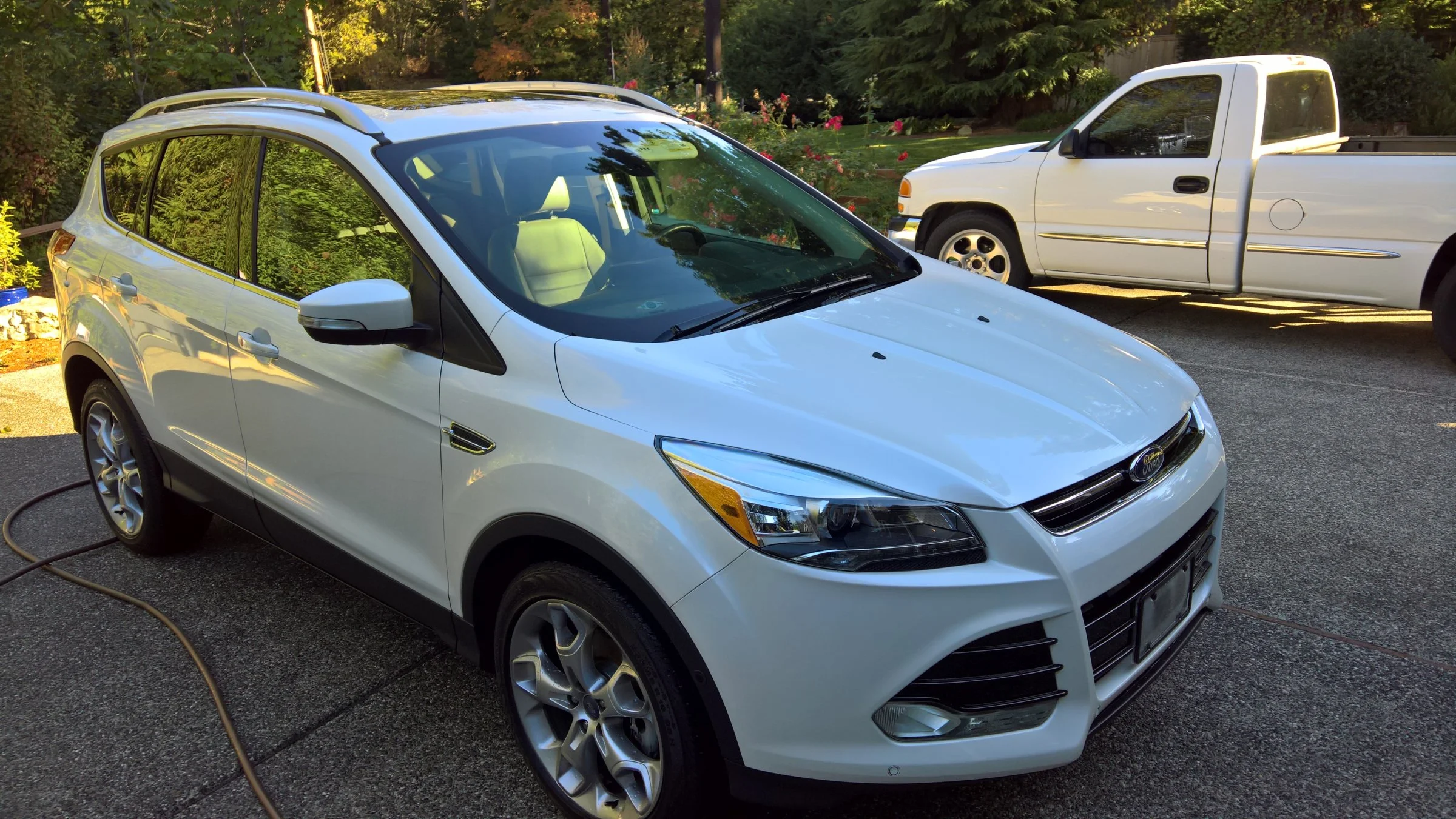

My mustang was coated 3 months ago (see pictures of the shine) and I jus did my wife's 2014 Escape she just bought. 29K miles, perfect body, didn't need to polish, just clay bar...It was that good. Again, check the picture. Questions ? Just ask me
Look at the reflection of the trees
