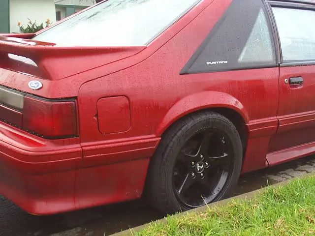

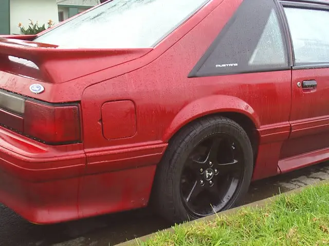

heres my black pony's , i like em without the center cap, took me 5 days to strip old paint off edge , sand & polish , then paint, only problem is there was some silicone on the rim from the "wet tire shine" ****, which i did try to wash off with simple green, but didnt work and left some bubbles in the paint, i used dupont with my dad's gun
my black ponies
