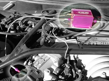

This is an OLD pic, but you should get the idea.
I traded someone for an MSD ST Brace mount. Basically it's a piece of alum. that has holes drilled to mount on the firewall where the ST bolts are.
I used a quick connect on the TPS line, so I could quickly disconnect it when pulling the intake off, and reroute it under the intake elbow. :nice:
Oh and I use Autolite 24s gapped at .035.

What they said. I just hooked up my kit that I wasnt using on my friends Acura and it was a breeze to install. If you want to double check on the TPS wire, back probe each wire and it will be the one that is X.XX volts with the throttle closed, and around 5 volts at WOT. Im going to be mounting my NMU inside my fender and everything will be completly hidden. If you run the nitrous line under your car, run it through a subframe or something to protect it a little.
