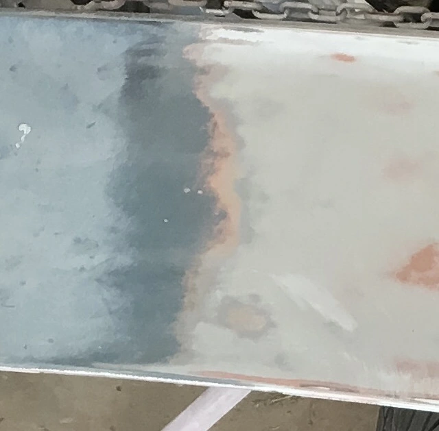

I would personally use 320 to do this. You'll want to keep your da flat while doing it. I'll need to post a picture of a properly feathered edge. I have one from when I was stripping my spoiler on doby. Look how the paint smoothly transitions from one layer of paint to the next.
