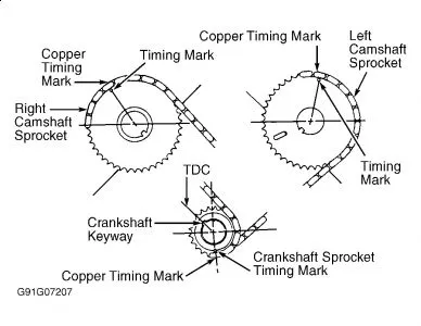

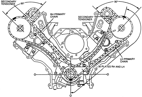

Im currently building a 97 cobra motor and have not found any clear literature on how to time it when i put it back together. Im porting and polishing heads myself and build from crank up. I do have a chiltons manual but it is very vauge on this subject.Any help??
