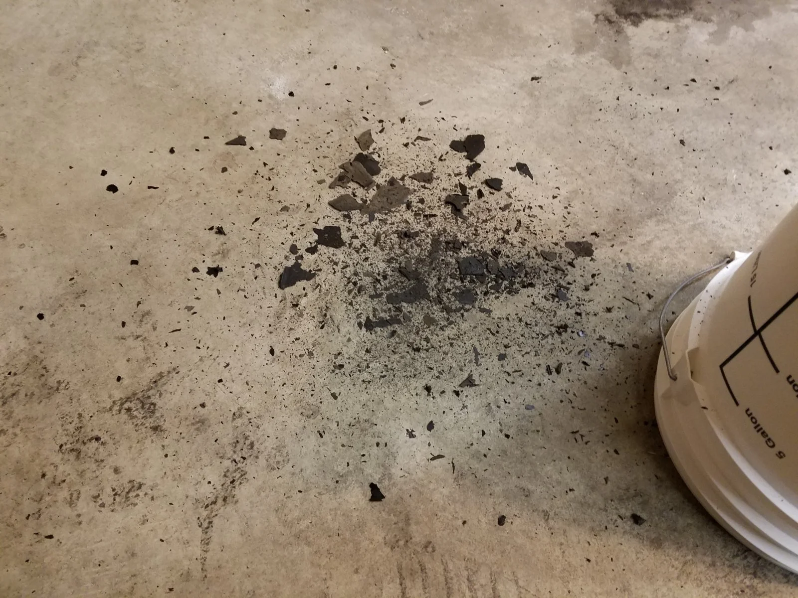

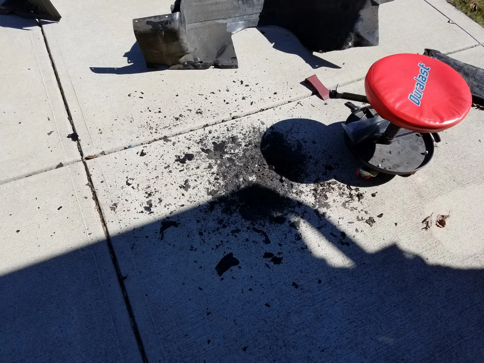

i got that crap all over mine too, been dreading stripping the bottom of the car for a while now. are you just soaking a rag in the spirits, or are you spraying it on and letting it soak?I've also been more deliberate about removing the 20+ year old Ziebart coating from stuff when I can. One of the PO's had this done to the car, and while I concede that it might be part of the reason the car is completely rust free, I still hate it. Every surface under the car, inside the fenders and in the engine bay are coated with this gooey black tar. The silver lining is that now it's old enough that it's starting to dry out and flake off on its own.
This pile is from ONE fender liner:
And this is from cleaning off the windshield fluid reservoir:
Pro-tip: plastic trim removal scrapers and mineral spirits are your best friends in removing this junk.

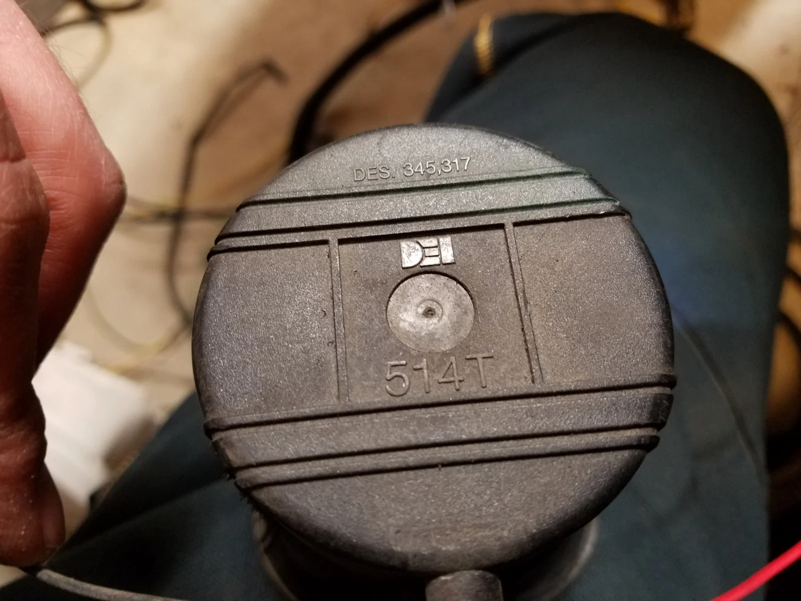

Anybody have any experience with these DEI "soft chirp" sirens? This one is a 514T, which looks like is no longer in production. It's probably 20+ years old and intermittently doesn't "chirp" when it should. I'd like to replace it but I don't know what model to replace it with.
