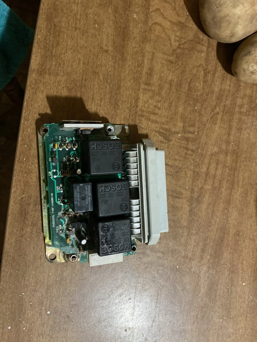

For the longest time I’ve had a serious problem. While running whether driving or not, and at times intermittently, also almost exclusively at operating temp I have a check engine light pop up and the car looses all power. Idling the car flutters and bumps just barely enough power to run when this happens. I pulled the ccrm and cut it open. I found the board to be burned around the farther right relay if the plug in is facing away from you. From what I’ve saw it is the Low Fan relay. When it blew it stayed in that condition. I replaced the ccrm and have had the same issue on and off. With the new ccrm -When it happens it usually continues until the car sits for a few hours.
