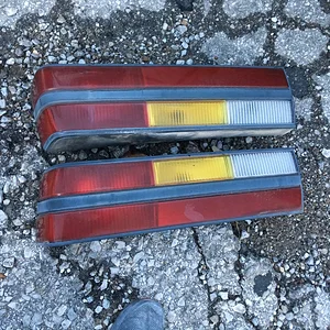

Before pull
Before pull

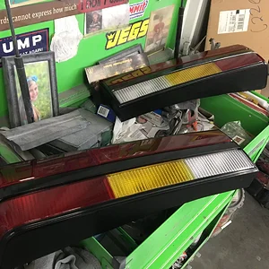

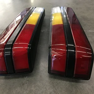

Taillights
Taillights

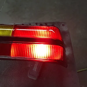

With a light shining from the backside, bound to be brighter with the light inside.
Taillights
Taillights

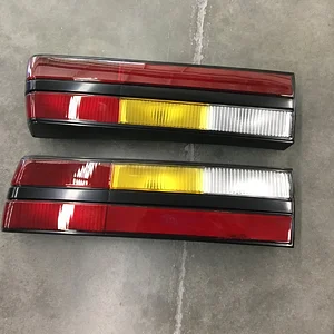

Housing black refinished, taillights completed.
Taillights
Taillights
Cleared and black refinished
Taillights
Taillights
Lenses sanded down with 400 grit and clearcoated.
Taillights
Taillights

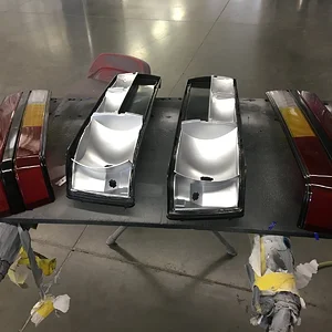

Silver reflector refinished.
Taillights
Taillights

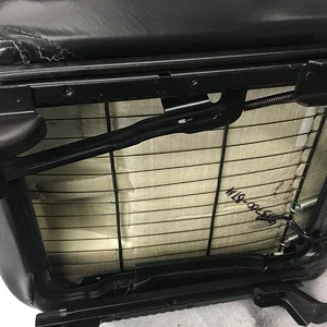

Bottom assembled with new foam and painted cover. Obviously the rails are blasted and painted

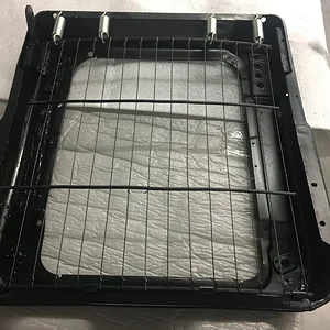

Finished welding and etched and painted black

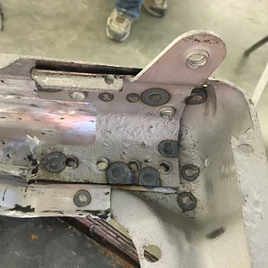

New patches and brace spot welded to the frame
Driver's Seat
Driver's Seat

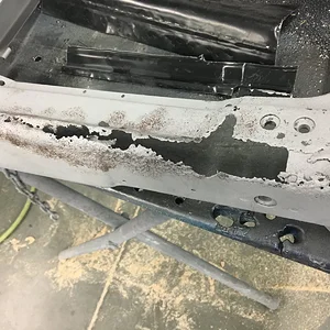

Rot cut out with new patch panels and brace cleaned up.

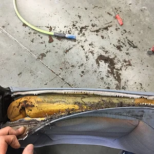

Wasted zipper

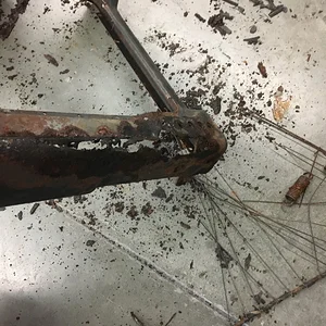

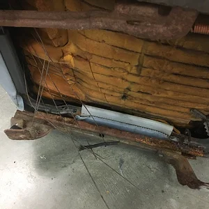

Frame is rusted just a little bit.
