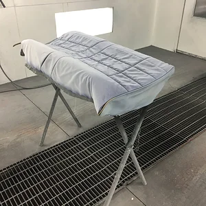

I had to resew some of the seams, then i sanded the vinyl and sprayed adhesion promoter and my interior black on them. I tested this method for durability btw. PM me if you want more information.

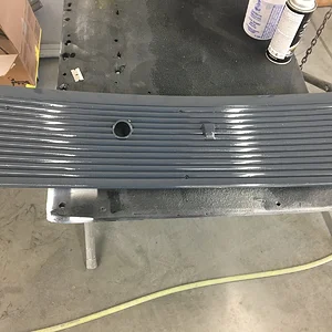

Cowel Panel
Cowel Panel
Trim grey with satin finish to match the hood
Cowel Panel
Cowel Panel
In primer

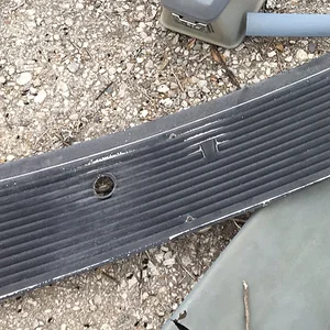

Cowel Trim
Cowel Trim
Fresh off the car

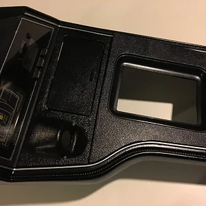

Interior Console
Interior Console
Silver piping
Interior Console
Interior Console
Redid the silver piping around the shifter
Interior Console
Interior Console

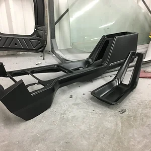

Painted black

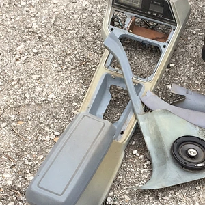

Interior Console
Interior Console
At the junk yard

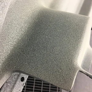

I then sprayed a fine rocker chip guard over the entire panel to give it a textured look somewhat like original. I sanded the rcg with 400 by hand to knock off the "sandy" feel of it prior to paint.

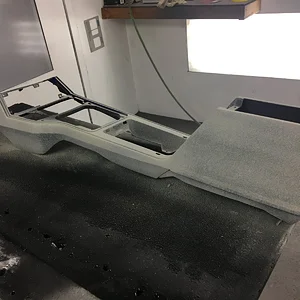

I sanded the entire panel with 80 grit, then 180 grit sandpaper. I sprayed adhesion promoter and black primer on it then.

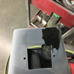

Interior 1/4
Interior 1/4

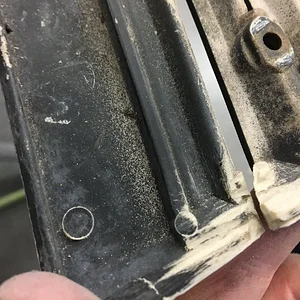

I used Panel Bonding Adhesive and drywall mesh tape to repair this area. I sanded the area with 80 grit on my DA sander first. I also used a plastic adhesion promoter to help with it to adhere to the plastic.
