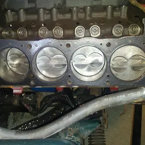

2.3 turbo motor, cylinders 1-2 leaking into each other as well as 2,3 3,4 possible cause of car being junked was.... blown/ leaking head gasket

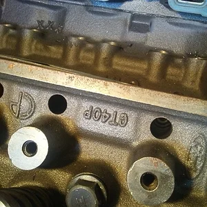

Original cylinder Head
YUCK, exhaust valves look beat to hell, cracks on exhaust seats on chambers 2 and 3 other possible reason for car being junked possibly caused by overheating and or clogged head gasket
Original Block Deck w/pistons

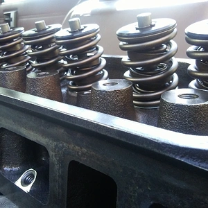

Valve Train!
Valve Train!
Worn the hell out slider cam, head full of rat turds somehow

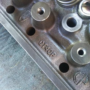

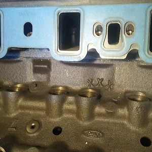

2.3 head surface
2.3 head surface
