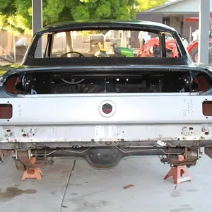

rear view of the welded body shell inner structure is tomarrows project

the body shell is finnished ,except for grinding the spot welds

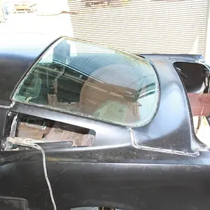

the lower rear window panel is welded in and a back glass is set in place, perfect fit

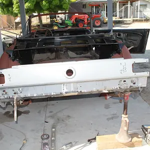

the rear roof brace is now welded in place and so is the lower rear window area several hours spent in this area measureing and re measuring as the tail panel and quarters and trunk lid were fit all at the same time.got word that jim smart may want to do an article on this conversion for mustangs monthly magazine

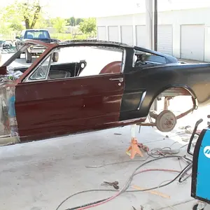

pass side quarter now welded in place ,again only welded at the door jamb and lower rocker area

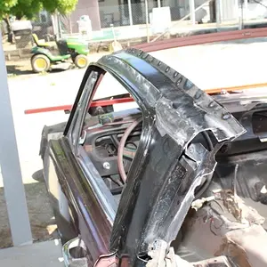

pass side door structure and rain gutter now in place, again lots of measureing

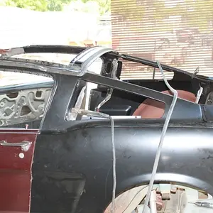

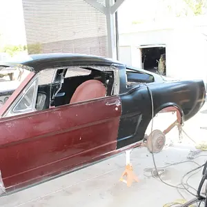

drivers quarter now in place ,starting to look like a fast back
Imported Item
Imported Item
the driver quarter is fit to the car and welded only at the door jamb and the lower rocker i needed to be able to move the quarter at the tail panel and below rear window for final adjustments, i fit the doors to the coupe before i striped off the sheet metal for future alighnment of the fastback sheetmetal, perfect gaps

end of quarter is welded in

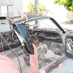

the rain gutter goes on now

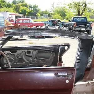

67 door structure was measured and measured and measured again when i was satisfied i welded it in place ,i have a 65 fastback for measurements

tail light panel is next,centered leveled and checked for heigth and finaly wellded
