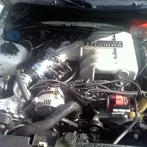

From the engine bay

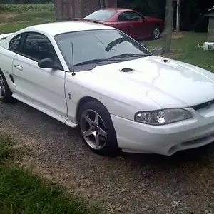

Pics do not do it justice. It looks great in person.

Engine before: 302, powermax cam, V1 Vortech 6psi, Hooker equal length headers, off road H pipe.
