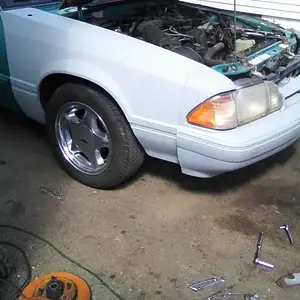

back from paint for a week....motor swap time. 10.5:1 aluminum RHS heads, custom grind crower cam, forged internals 306, trick flow intake, 75mm bbk throttle body, msd ignition+distributor, 24lb injectors, 80mm C+L mass air, billet flywheel, ram powergrip HD clutch. 1.6 /1.7 roller rocker combo (stud mount) with fabricated aluminum valve covers.

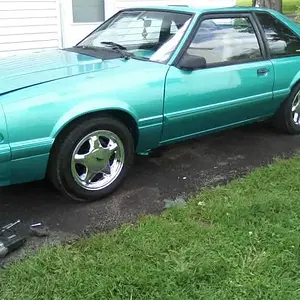

finally back from paint!

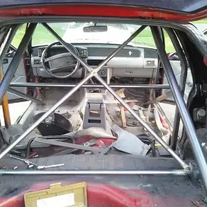

installing the cage. went with the through the floor "outrigger" cage.

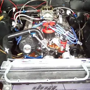

finally in and running! high compression 306 , hp 750 carb with 850 proform main body. 200 shot progressive nitrous. alum heads, .200 dome pistons, steel crank/rods, funnel web intake, fabricated valve covers, manual rack and pinion....on ...and on....and on....

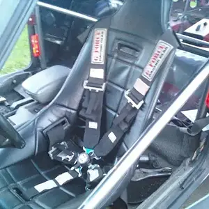

new seats and harnesses.

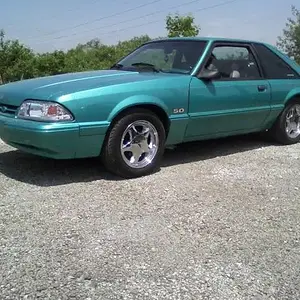

just got the new front end on for her. almost ready for paint. added some chrome ponies for her instead of those "oh so desireable" rubber lx wheels!
