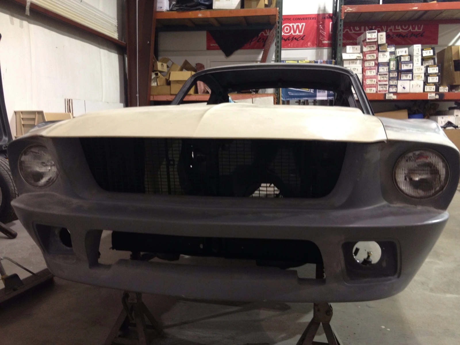

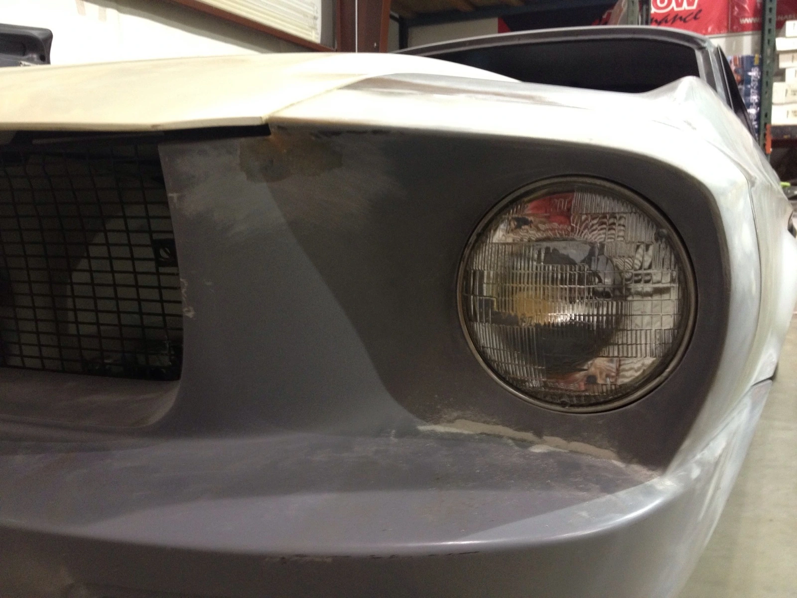

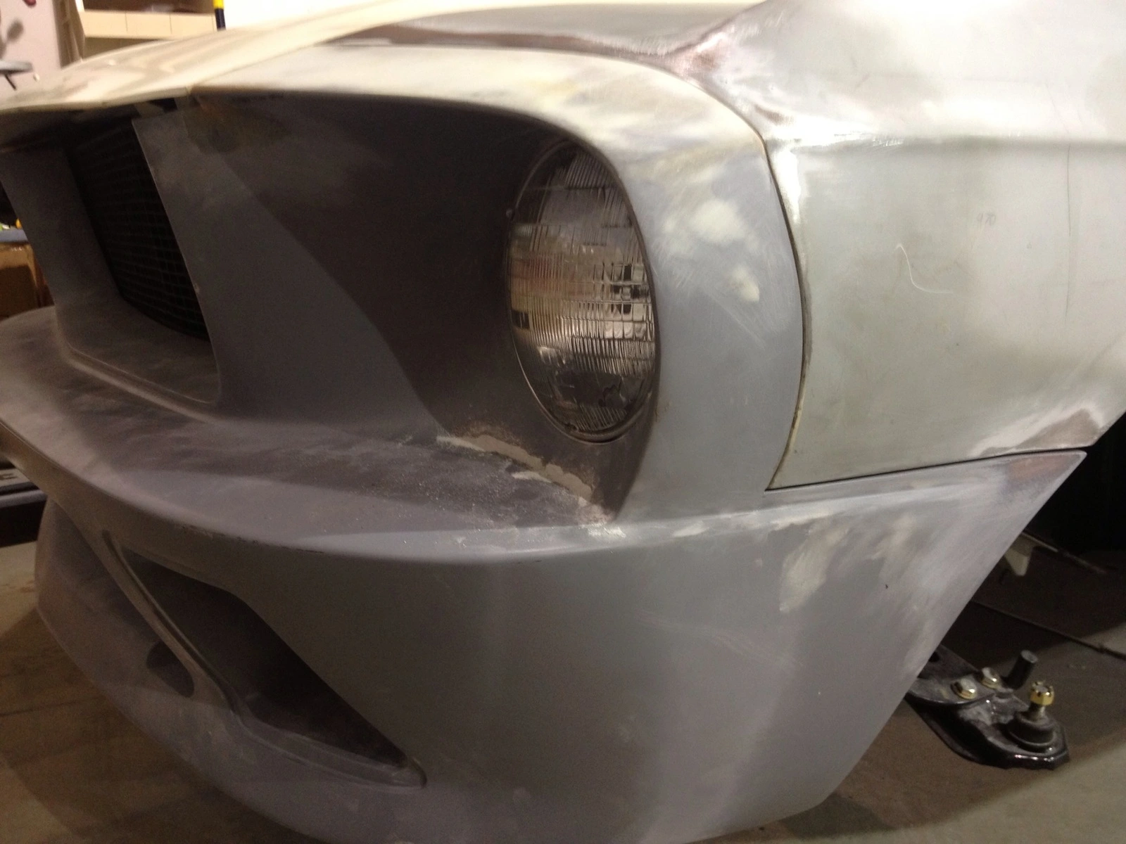

Finally worked the headlights in. They are mounted to the fenders, not the front cover like a stock setup. We ended up using the light buckets from a 76 Ford bronco/truck setup to get a solid mount. We still need to work on the clearance surround to get a nice gap but the headlights are in nice and will work perfect. They will need to be adjusted before mounting the front fascia for the last time after paint/build.

Working the CDC front fascia in and getting the gaps and fitment right.
