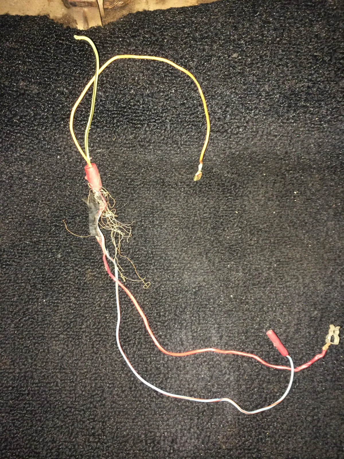

HA! I had an identical problem when I was replacing my taillight panel and installing the LED tail lights. The blinkers, reverse lights, radio, all went out at once. The horn was intermittent.
I ended up tearing this piece of burned up wiring out of from behind the dash. The melted red wire with the clip is from the fuse block. The yellow wire with the spade goes to the turn signal. The blue wire I think is reverse light on the gear shift? The yellow with the stripe is for the radio. The frayed copper goes to the firewall and the tranny switch and powers the back-up lights. They all get power from that factory junction. I spliced in new wires and everything works great!
The horn I fixed by soldering the wire to the round copper plate in the steering column. The wire just finally broke off.
