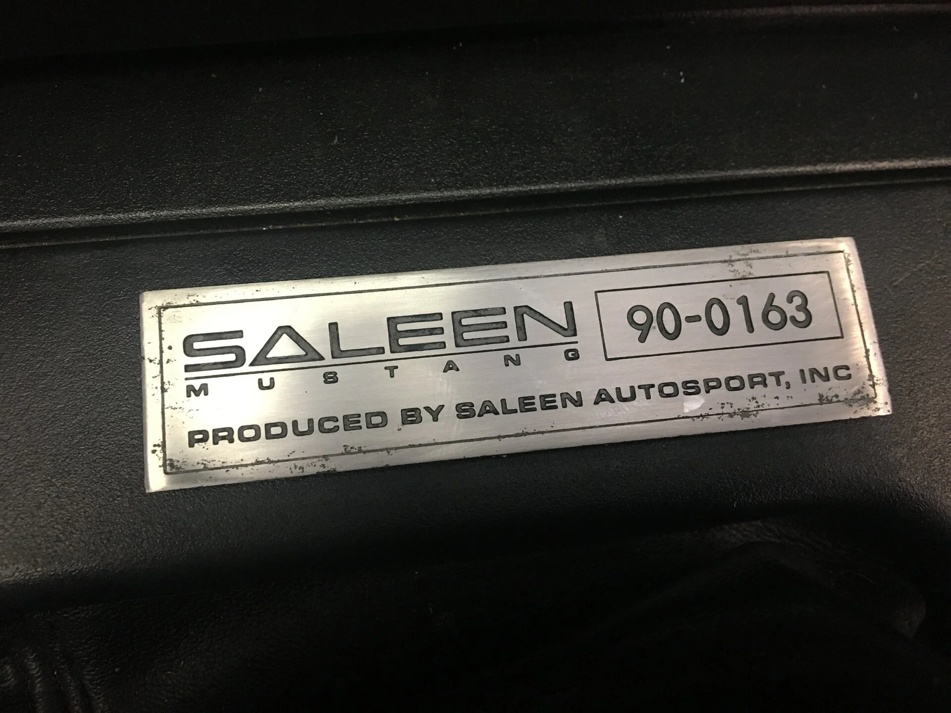

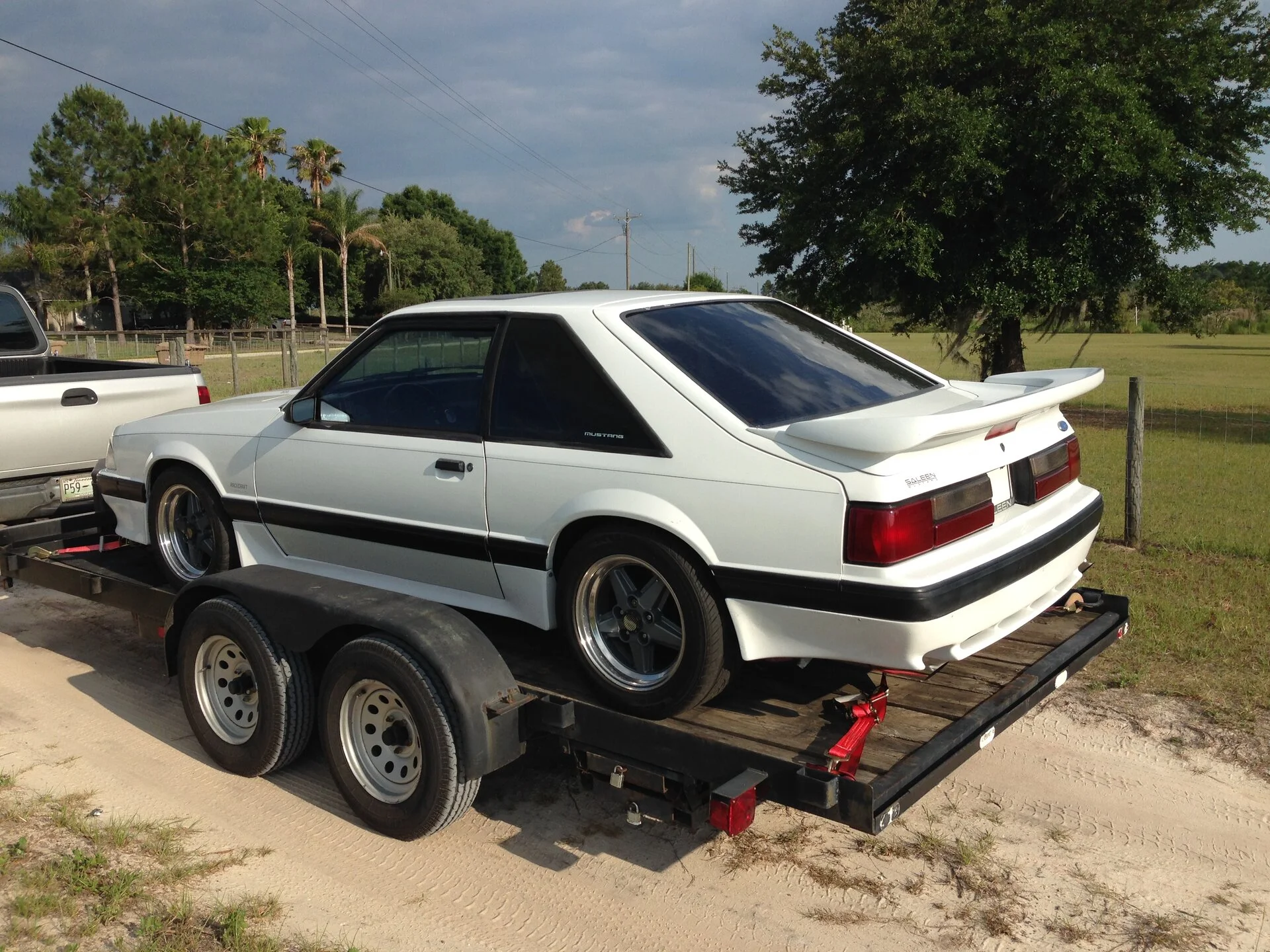

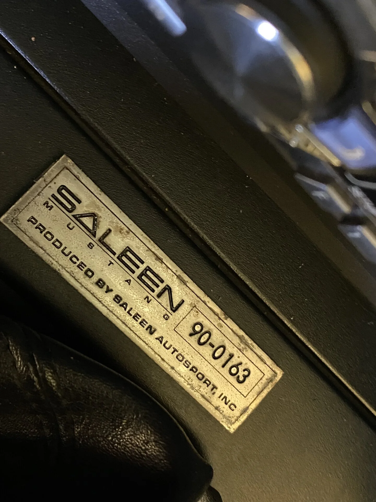

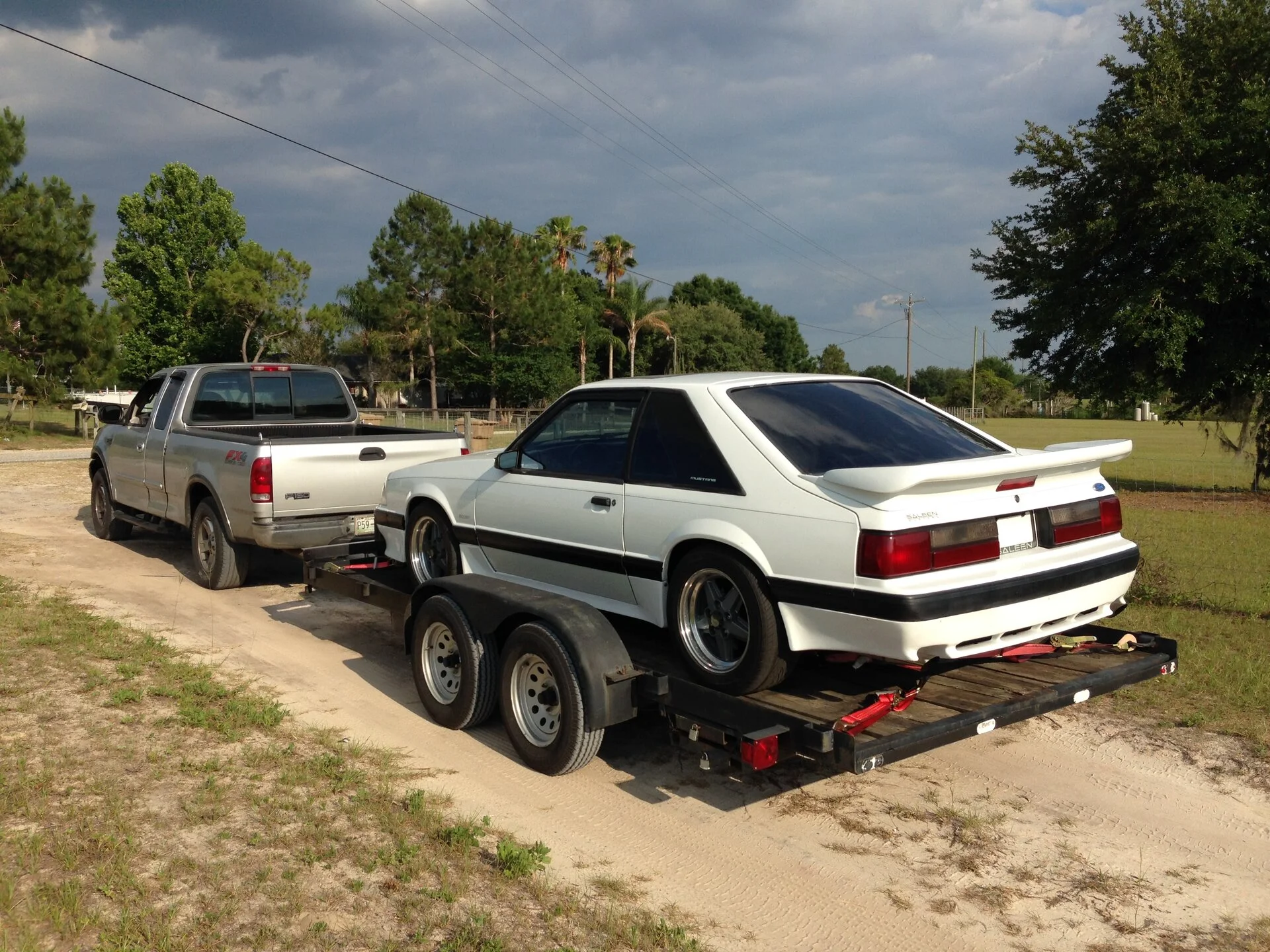

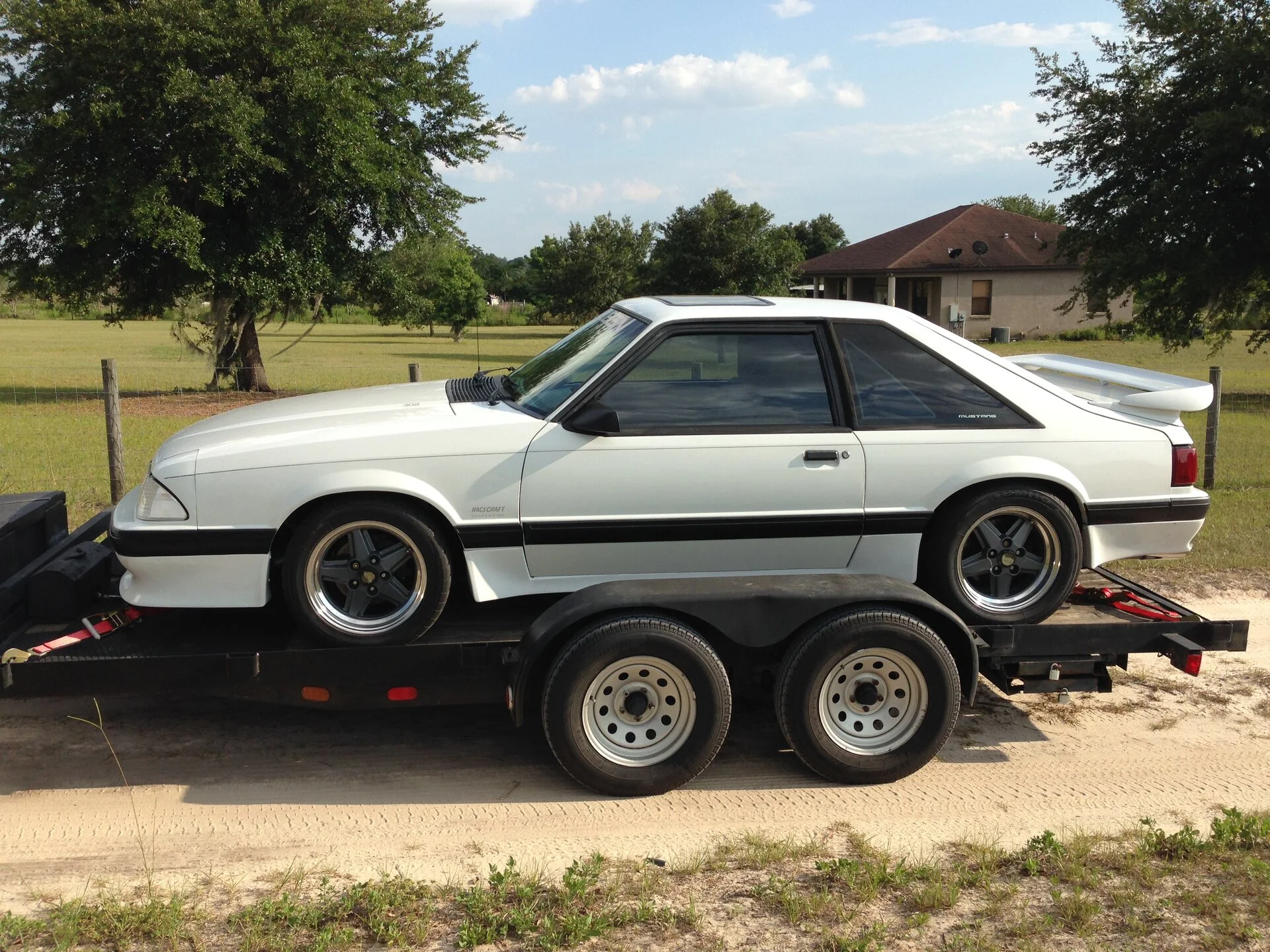

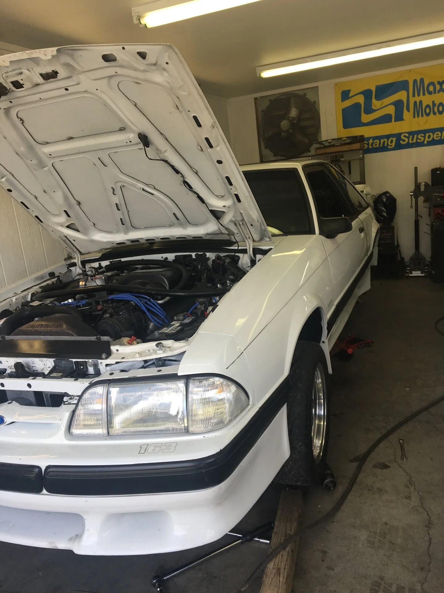

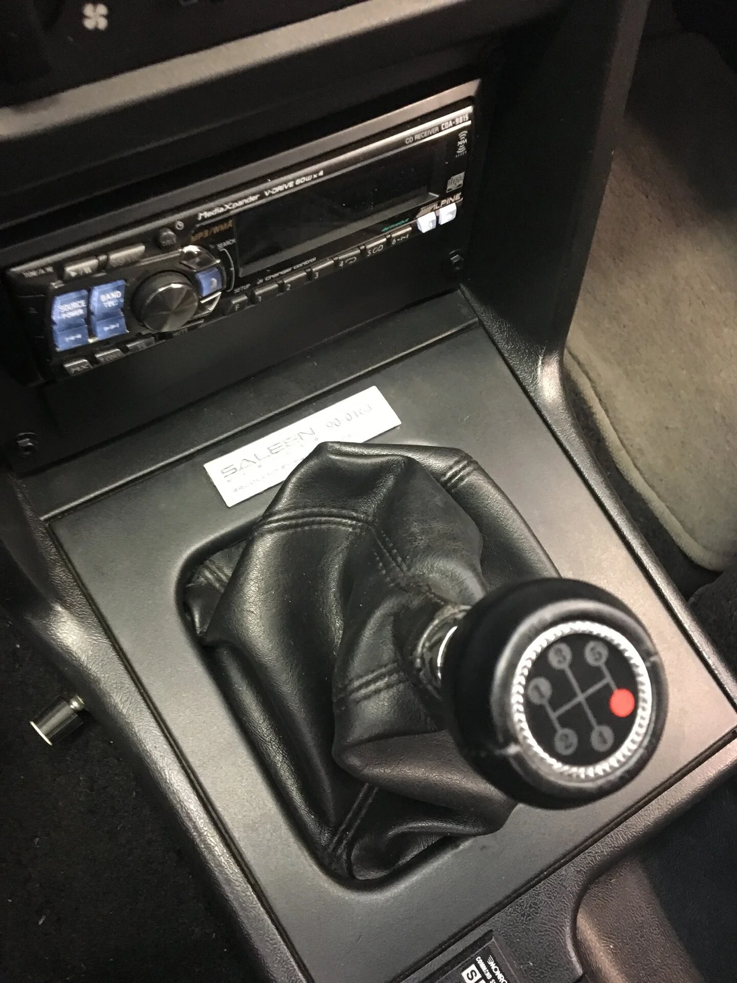

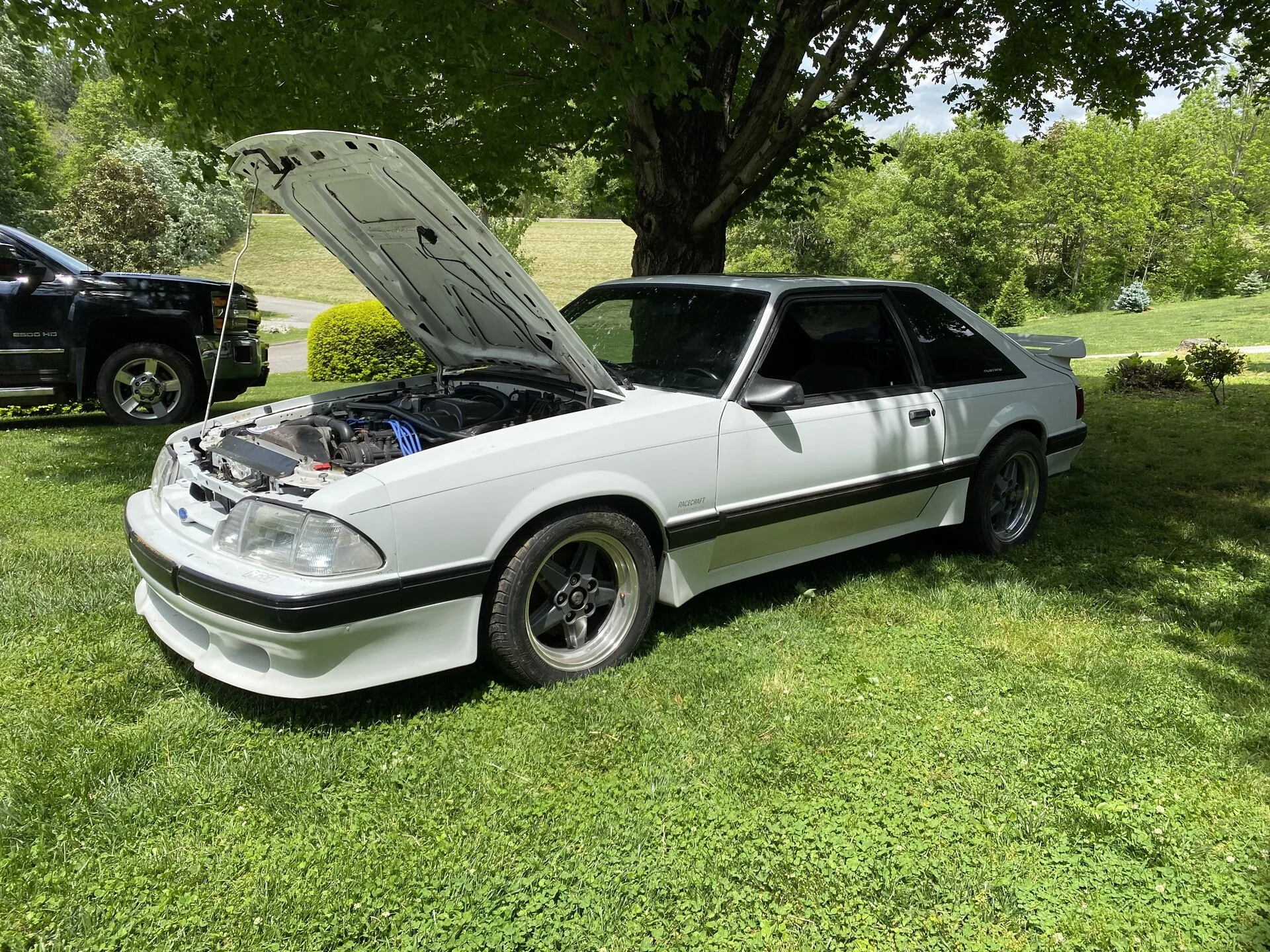

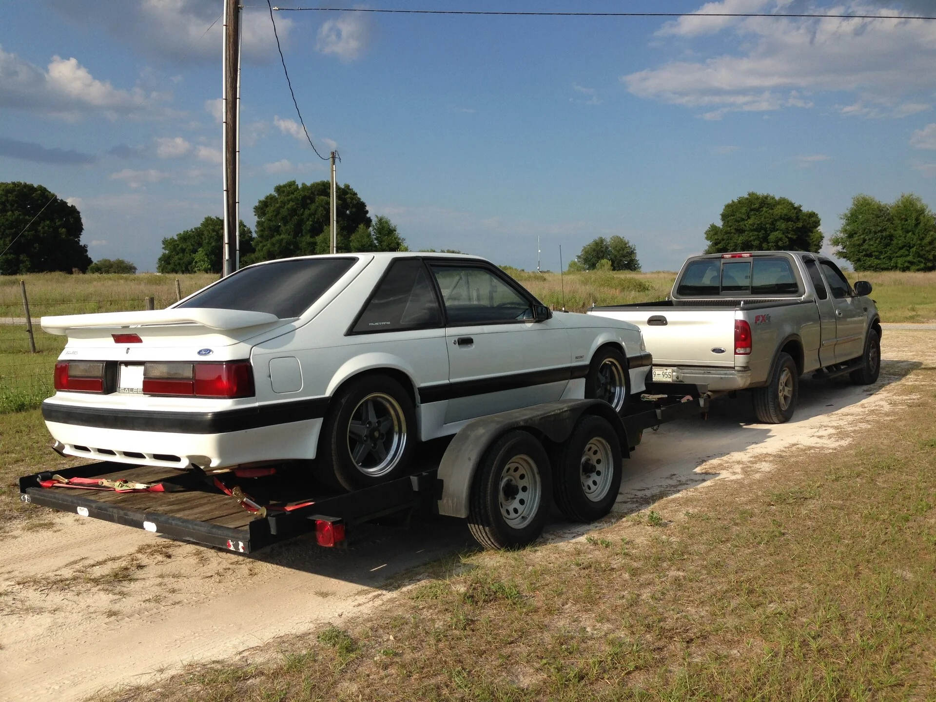

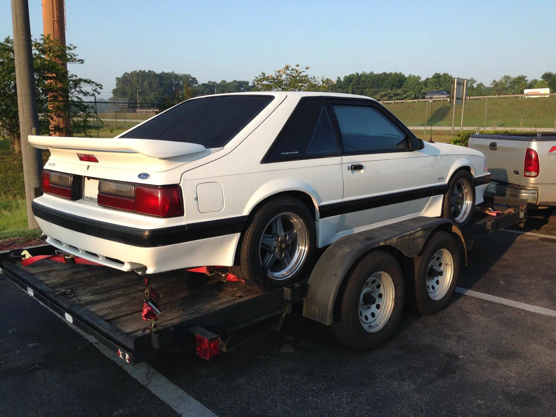

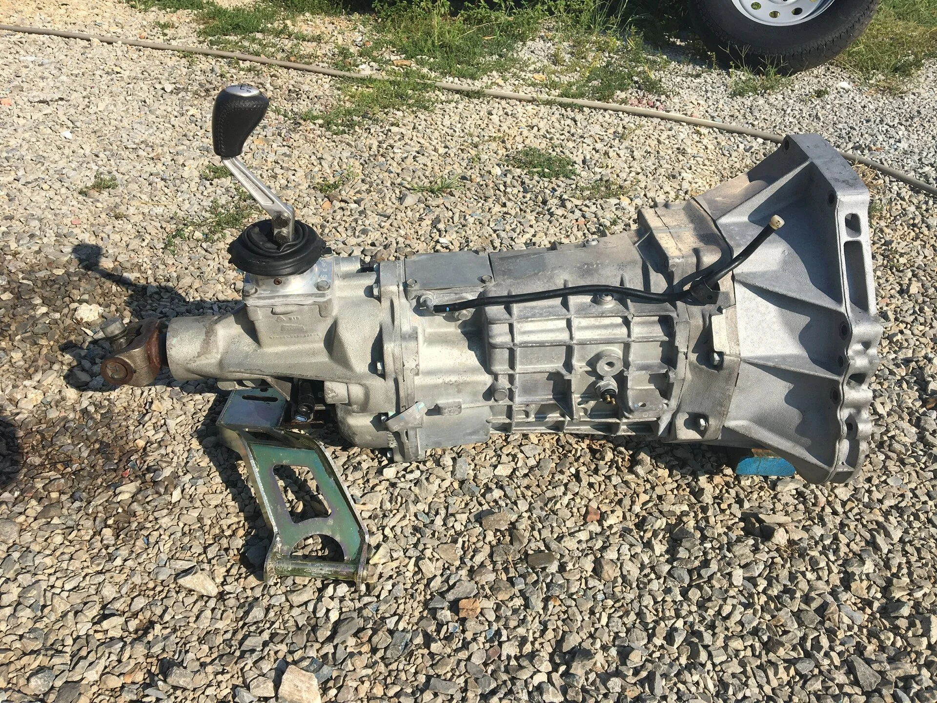

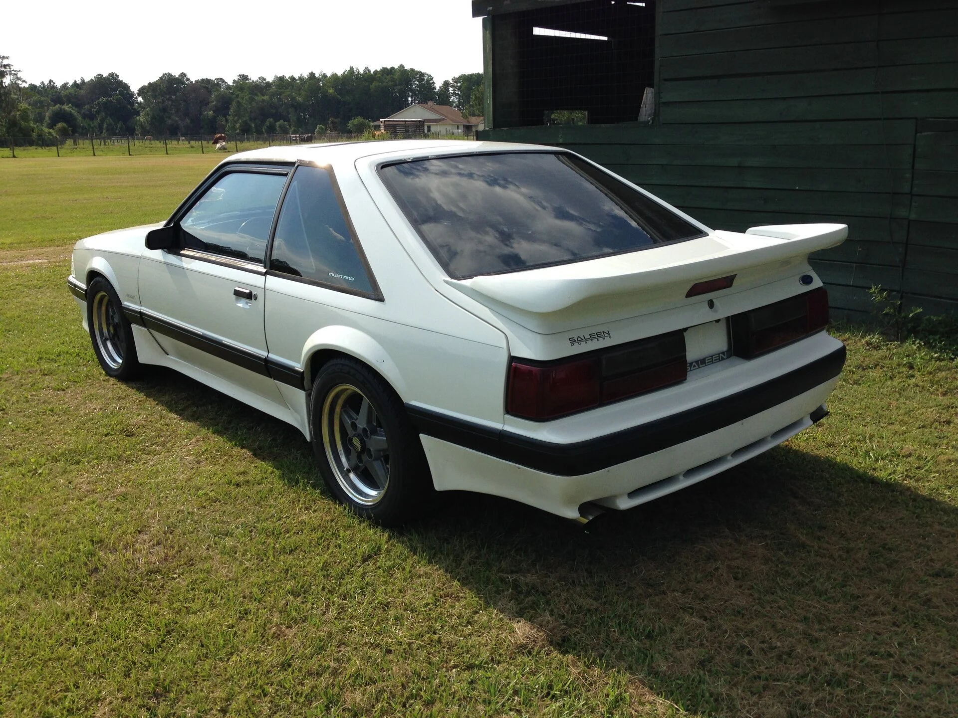

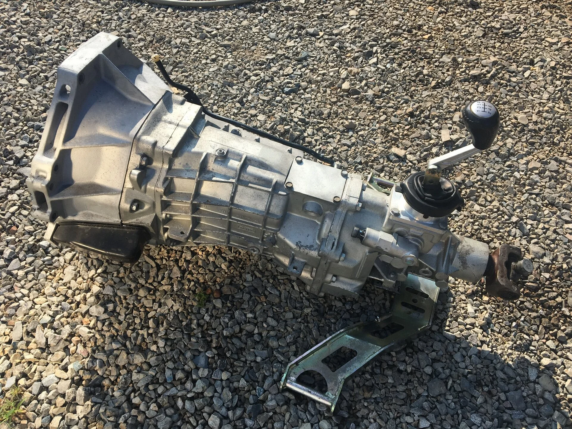

These are pics from 2019. My customer brought me the car to do a trans swap. Somewhere along the way, someone had put a 6 speed in this car and he wanted it to have a 5 speed like it came with. So I installed a tremec 3550.
tell me more about the adjustable suspension.
I was hoping for machine guns mounted someplace.
Lol! Nope.
It was called cockpit adjustable suspension and worked with the monroe adjustable shocks and struts. All long gone and replaced with race valved bilsteins, and MMs torque arms setup. Even back when new..it sounded cool but really did nothing. You were supposed to be able to adjust stiffness on the fly
