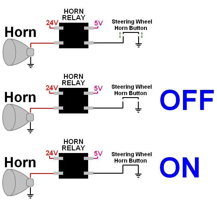

is the sliding contact a slip ring with several contacts (1 for the horn, 1 for the air bag, etc)
"ye/lg wire circuit #6 before splice #249 this splice is located near the gem module.. " ?????????? I have no idea about any of this, what it is or where it is located.
The horn worked before but now doesnt.
I attached a picture of more of what i meant by schematic. If someone had something like this (i dont know if my example is correct or not) that was correct would be great. and if it was something like this but inserted into a picture of the car showing exactly where the wires were and relays and switches and etc (all things involved with the horn circuit) that would be exactly what I was looking for.
Thanks

I am not aware of any single picture that shows both the circuit and physical location of components as you described. The example you posted pretty much applies to all cars. In the Mustang, the points marked "5V" and "24V" connect together then to the battery (+12V) through a fuse. Other than that, the only difference is the connections to the both ends of the horn switch are routed through the "clockspring" cable. Servicing the clockspring is an involved project, as it is mounted directly behind the steering wheel. Both the driver airbag and steering wheel must be removed to access it. I would want to be 100% sure the clockspring is bad before attempting this repair.
