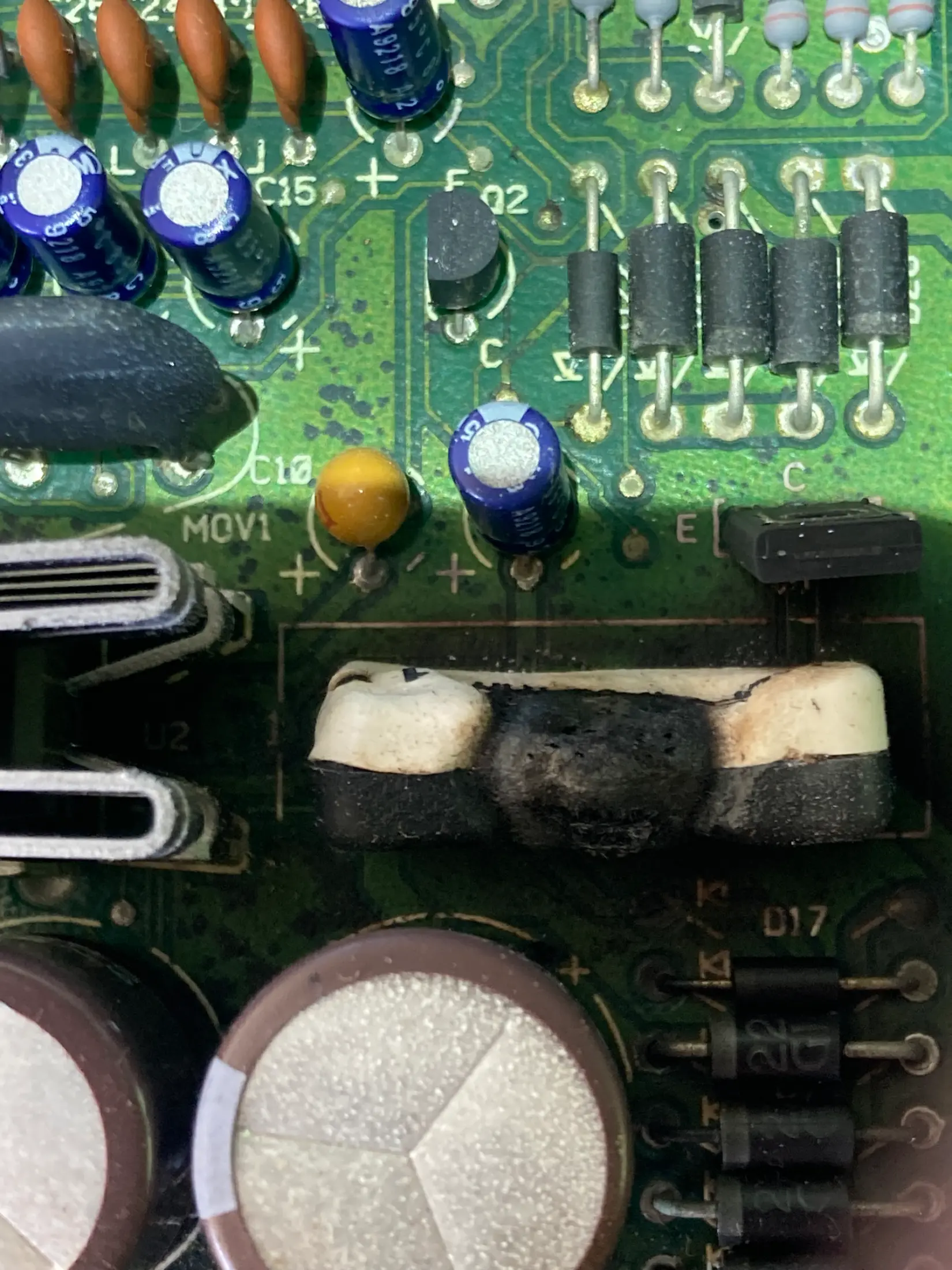

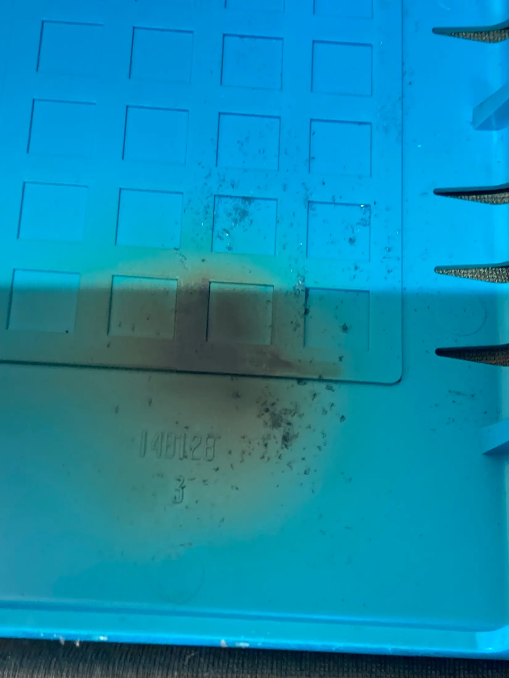

Thanks, mine is flashing code 13. As old as these vehicles are I don’t think any dealers will work on them nor local mechanics as far as airbags. I work on about anything but I’ve never worked on any airbag systems. Most parts seem to be discontinued that’s airbag related which is odd considering these are popular cars. I’ve seen one company that rebuilds the modules but I haven’t read anything positive about them.
Thanks, mine is flashing code 13. As old as these vehicles are I don’t think any dealers will work on them nor local mechanics as far as airbags. I work on about anything but I’ve never worked on any airbag systems. Most parts seem to be discontinued that’s airbag related which is odd considering these are popular cars. I’ve seen one company that rebuilds the modules but I haven’t read anything positive about them. I’ve taken the module out and opened it up and it’s fried!!!

Looks like the internal thermal fuse let loose. It self destructs when a condition exist that it feels could trigger a false deployment. It's a safety measure.
So your bad clockspring or whatever is wrong with the system told the module the air bag could accidently go off. Then self destruct initiative begins

Well I removed the module and disconnected the airbag itself until I can solve the issue. At least I won’t have to worry about it deploying or hearing the beeping. I appreciate it
