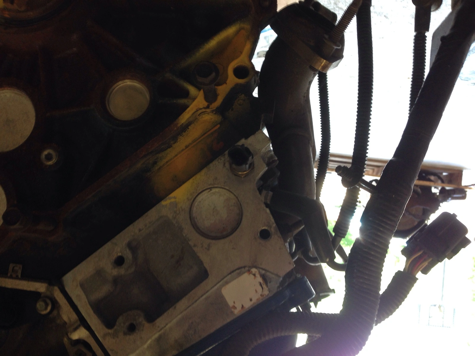

The new engine harness arrived yesterday. I tried plugging in the various sensors and found that the connector that should mate with what appears to be a temp switch that screws into the aft end of the the DS head is way on the other side of the engine. Maybe I routed the harness wrong? There's only one of 2 possible ways it can go on since the injectors are laid out on either side. I'll try switchig sides but it looks like one of the EGR switch conncetors may not reach if I do.

Also, I located the connector for the coil and determined I had the harness laid out correctly. I started snapping connectors into place and with the exception of the sensor on the back of the DS head, everything is lining up very well.

In the center of the picture there's a sensor that screws into the back of the head, but there is no connector in the engine harness that connects to it. Is the connector in the transmission harness? Can someone with an '01-'04 help us out?
