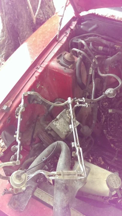

The first picture shows the rear of the engine and fuel rail.
this is the old style rail.
