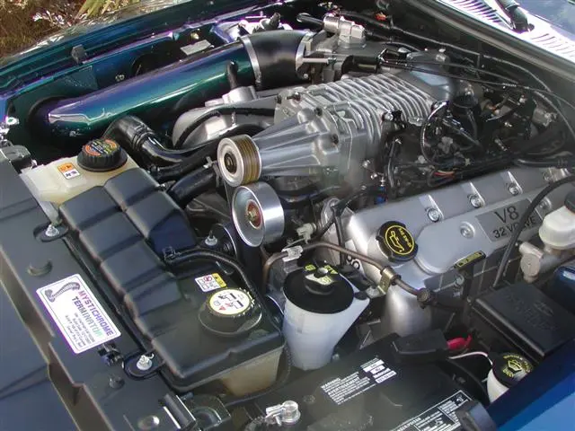

I have and recommend Billetflow pullies. I run NGK TR6IX irridiums...they are a colder plug
Billetflow is a great choice for pulleys as stated above. See if you can find someone in your local area that already has an Eaton M112 pulley removal/installation tool. They are expensive. Now that I think about it... doesn't Billetflow rent these tools now? Check their website.
