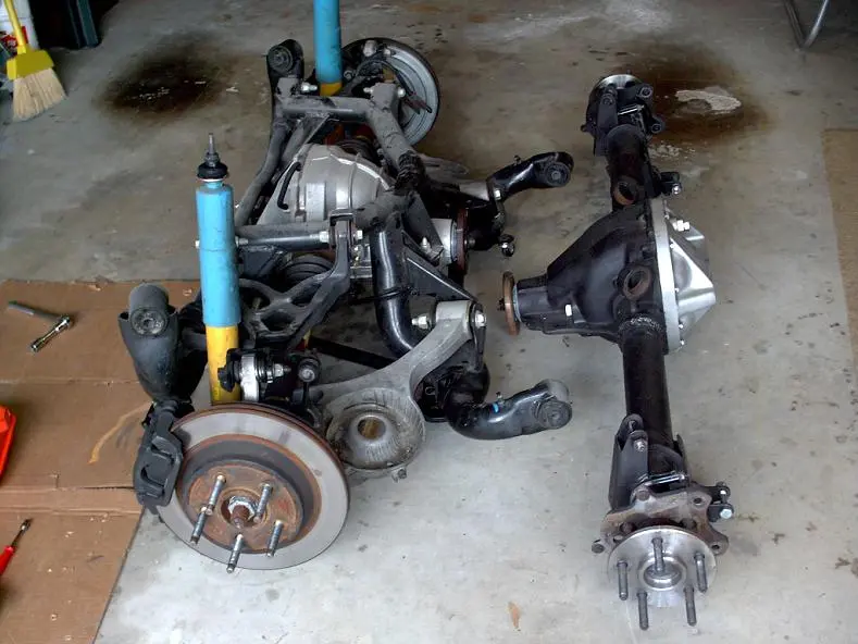

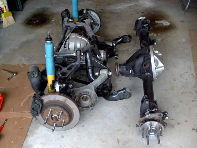

iknow meat but they want 1000 bucks for a complete one. it just has stock internals 28 splines out of a 03 mach1 ? you think i need one? is that i good price for a complete one 1000 bucks? shock springs and all c/ arms abs sensors??? will the 28 splines hold up to my car , the mach1 had 3.555 just like my cobra got .?
Uncle Meat said:
You should be able to find a GT owner who will trade you their stock 8.8 + cash for your IRS. Just post a "Want To Trade" message in the regional classifieds.
U.M.
i can get a gt one for 700 bucks , but the mach1 has larger 13 in rotors in the back and i wont have to swap the gears either. is worth the extra 300. heck i'll sell my irs for 1200 bucks that will pay for shipping cost no the mach1 rear. i just need to change the drive shaft flange on the rear if iam correct? and use same drive shaft too?
