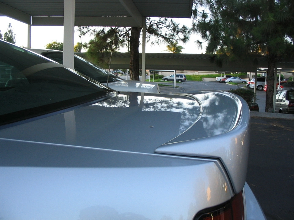

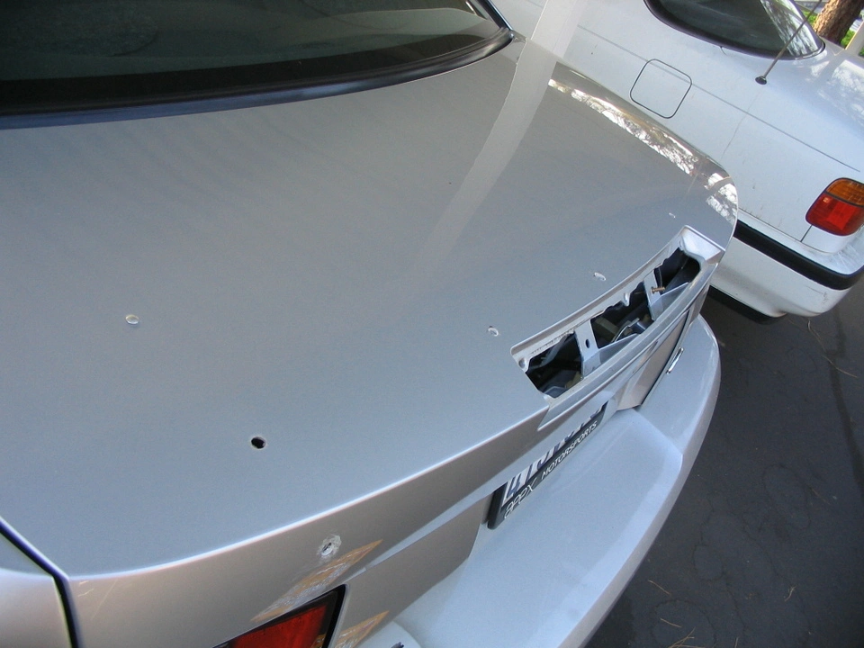

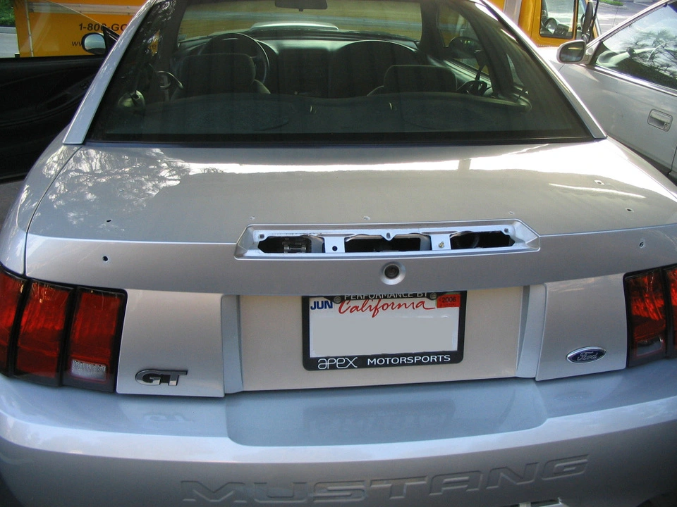

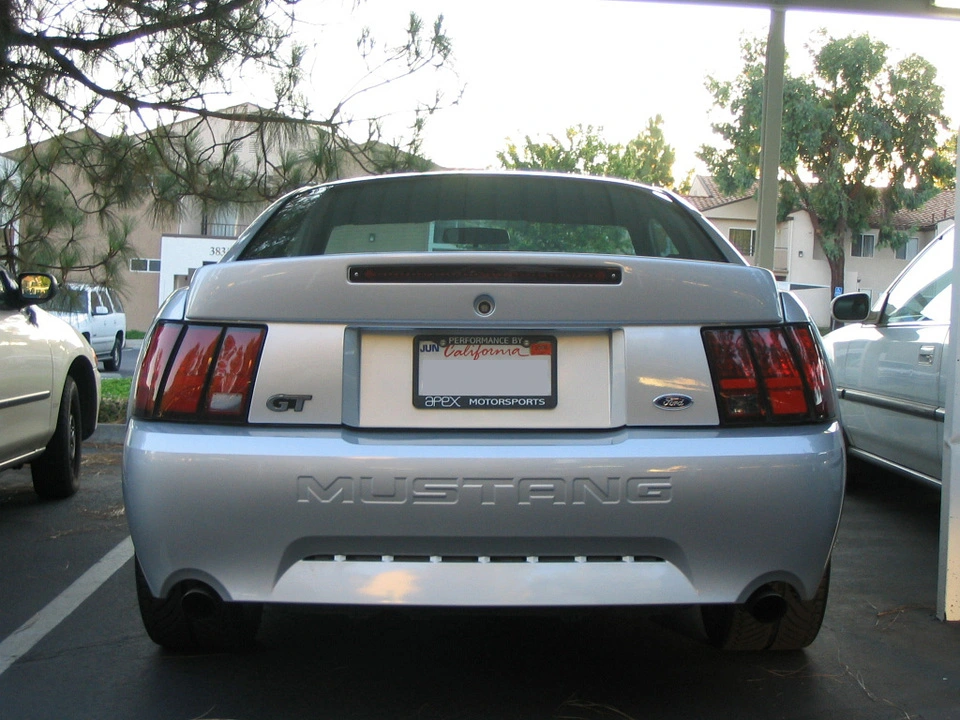

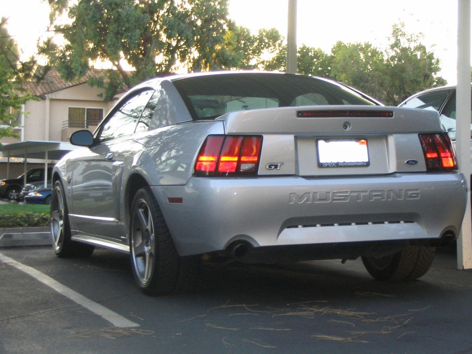

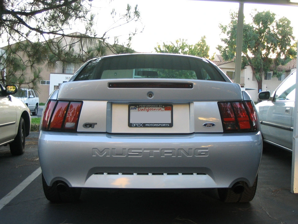

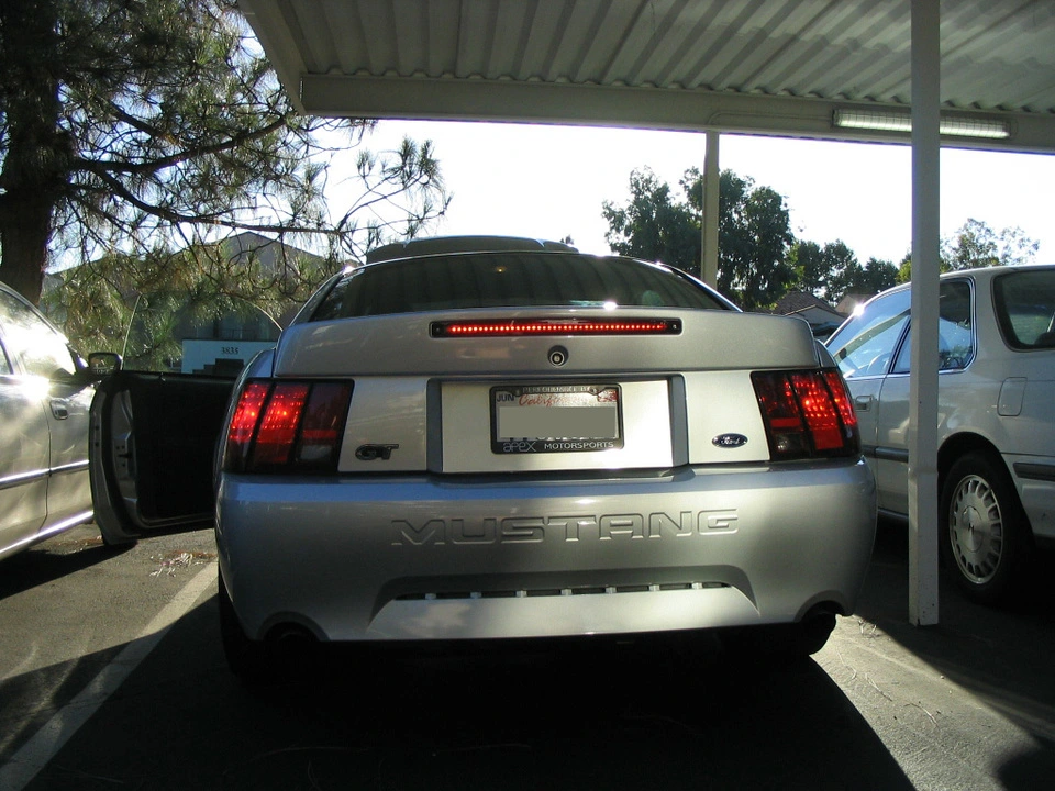

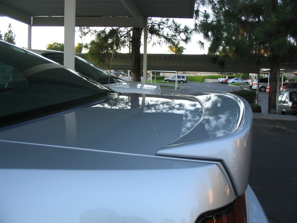

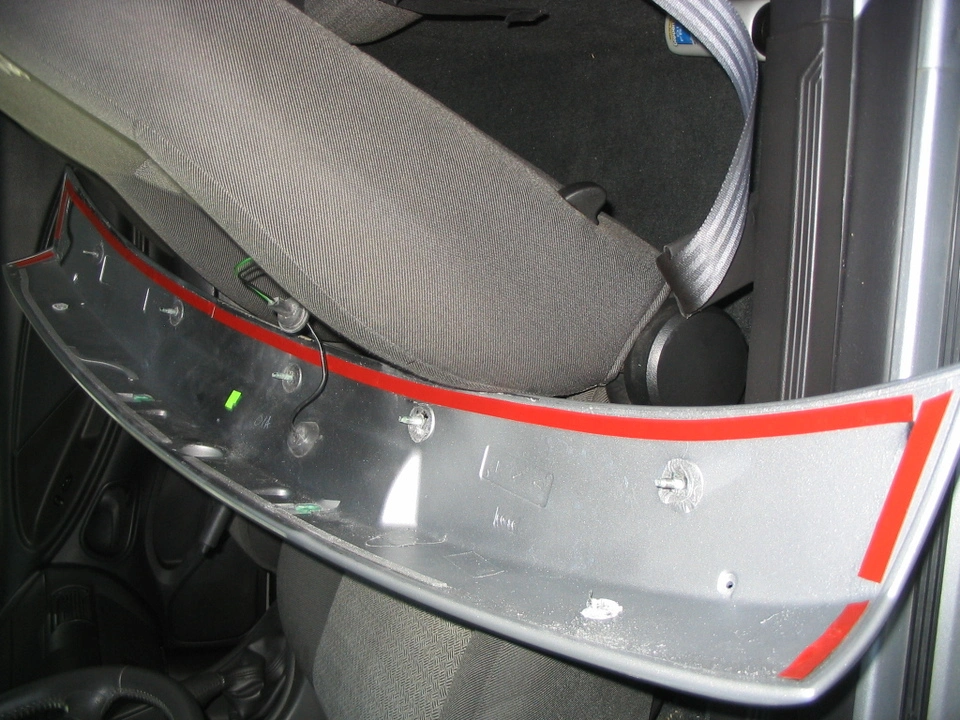

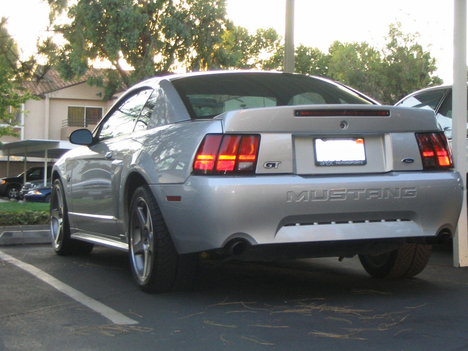

Well, its finally complete. These were my steps to complete the job.
1. 2 Hillman Nylon hole plugs for the exposed holes, silver paint touch up paint, and a clear coat
2. Wiring Harness (you need a new one, running from the left panel inside the trunk, to the spoiler because it is run by LCD, not bulbs). There are about 5 clips/plugs with lights etc.

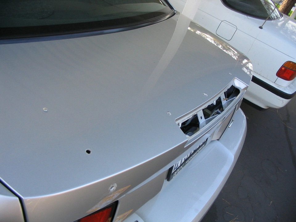

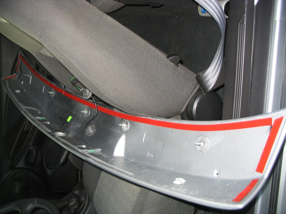

3. After the spoiler has been painted etc., I used double sided tape as shown below, to try and keep water from getting under the spoiler.
4. Line up the spoiler, make marks with a sharpie, and drill the holes (on 2001+ GT trunks, 2 of the original holes are used).

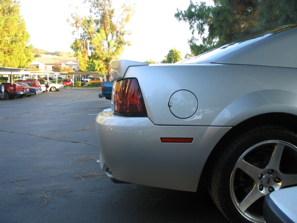

5. Throw it on and connect the brake light once the wiring harness is all set.
I had mine painted because it was originally shadow gray (got it off classifieds).. The paint shop repaired and painted my front bumper since it was damaged in a small accident. And since I was in a painting theme this month, i went ahead an painted the front grille horse flat black.
Let me know any questions
Wade

ponysarepretty said:
I think it looks a bit distended, I uess I would like it more if it were flush with the paint instead of obviously bolted on...
Well that would be some serious body work, and, IMO, that would look wrong. What he's done here is add the OEM Cobra spoiler to his GT...and I think it looks great. :cheers:
Don't mean to bring this back from the dead, but GREAT writeup! Looks awesome!
The whole cost ya around what? $350 for the spoiler, $89 for the light housing, and $250 painted? So like $700? Looks great. I love the 03 spoiler and wish I had $700 for a cosmetic right about now. :P
$140 shipped spoiler (classifieds)
$225 Paint
$90 LED 3rd Brake light
=$455 - $75 (selling OEM spoiler) = $380
It was worth it to have a car thats different.
Wade
