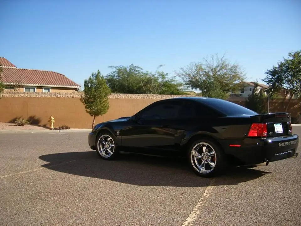

Hmm damn I was at Ford today and ordered the harness...it was like $64 bucks lol. I was just at the track and took a good look at someones cobra spoiler assembly. Seems pretty straight forward.
Damn your car looks awesome.....mine will look like that...I got a black 04 GT
