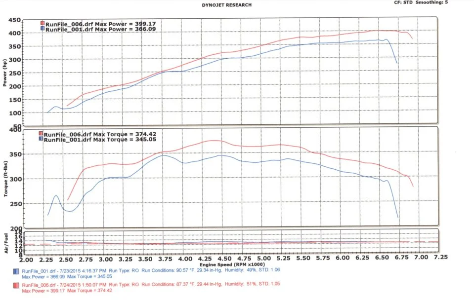

Stock M50 coyote, stock air intake with box cut out and cone filter, bbk LT. T56 magnum
4:10 rear, 400 Rwp and 374 TQ. On a 95 degree day - That's what my builder and tuner gave me- believe or not don't matter to me, I'll try and post up my dyno sheet later today

For all the Coyote fans that want honest info - Here's my Dyno, note the temp and humidity, there's more to be had
Reactions: smokin joe, RangerJoe, skyline247 and 2 others

Very comparable to a well built 302 stroker or h/c/i 351. @89oem nice dyno sheet! And you should post more pictures of your car!
For a nice day driver,that may occasionally see a track, I'd go coyote over a Windsor motor. Still would rather have one over a cobra 4.6 also.
Now a track car...hard to argue with cubic inches and a power adder.
