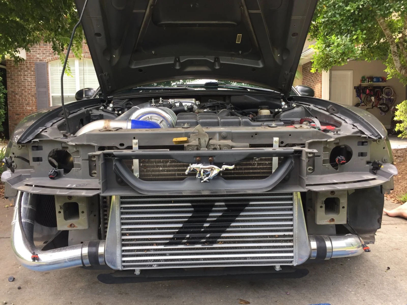

Another question i have is about the intercooler fitment, whichever sc kit i choose, i'm going to be installing an intercooler, are there any that are a better fitment than others? i've looked at the treadstone ones and they seem like thats what most prefer.
