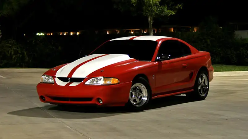

revhead347 said:
Yeah, that's the whole problem, I want to be able to run my 15" Pro Stars.
Kurt
You can if you don't mind running 1" spacers.
Yeah, I don't think that's a realistic option. My front wheels stick out far enough as it is, and that doesn't leave much stud for the lug nut to hold onto.

Good 1" spacers give you new studs to attach the wheels. The factory studs attach the spacer, the studs on the spacer attach the wheel..

Yeah, that's not too bad. I guess if you ran fox control arms it would work pretty well.
