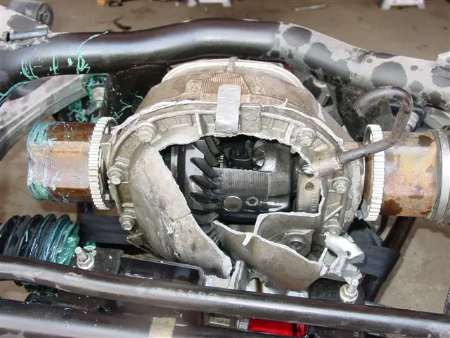

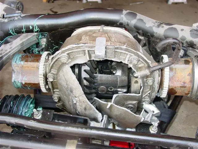

When you say "ripped apart" what exactly do you mean? Did it look like this:
The differential cover is one of the weak points in the rear end and many 03/04 Cobra owners have blown a hole right through the cover! This happens when heavy torque is transferred through the torque brace which mounts to the differential cover itself. The stock cover is brittle so it ends up breaking. To prevent this you can get one of MJ's (Billetflow) differential girdles which will prevent this from happening in the future.
