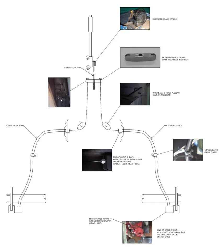

I swapped to cobra brakes on my 88, and the change to discs leaves me needing a new parking brake cable. I used calipers and brackets off an 04 cobra, does anyone know what parking brake cable I need? I was wondering if I could just use an 04 cobra cable, but I have no clue if it would be the right length. I'm sure someone here has done this swap before, so any help would be appreciated
Cant use the self adjust spring on the handle...You need, the shorter brake cables, to weld the brake handle onto the second notch on the gear, disable and remove the coiled handle spring, drill and add the nut adjusted cable to the handle to euqal8zer bar. follow the diagram below
