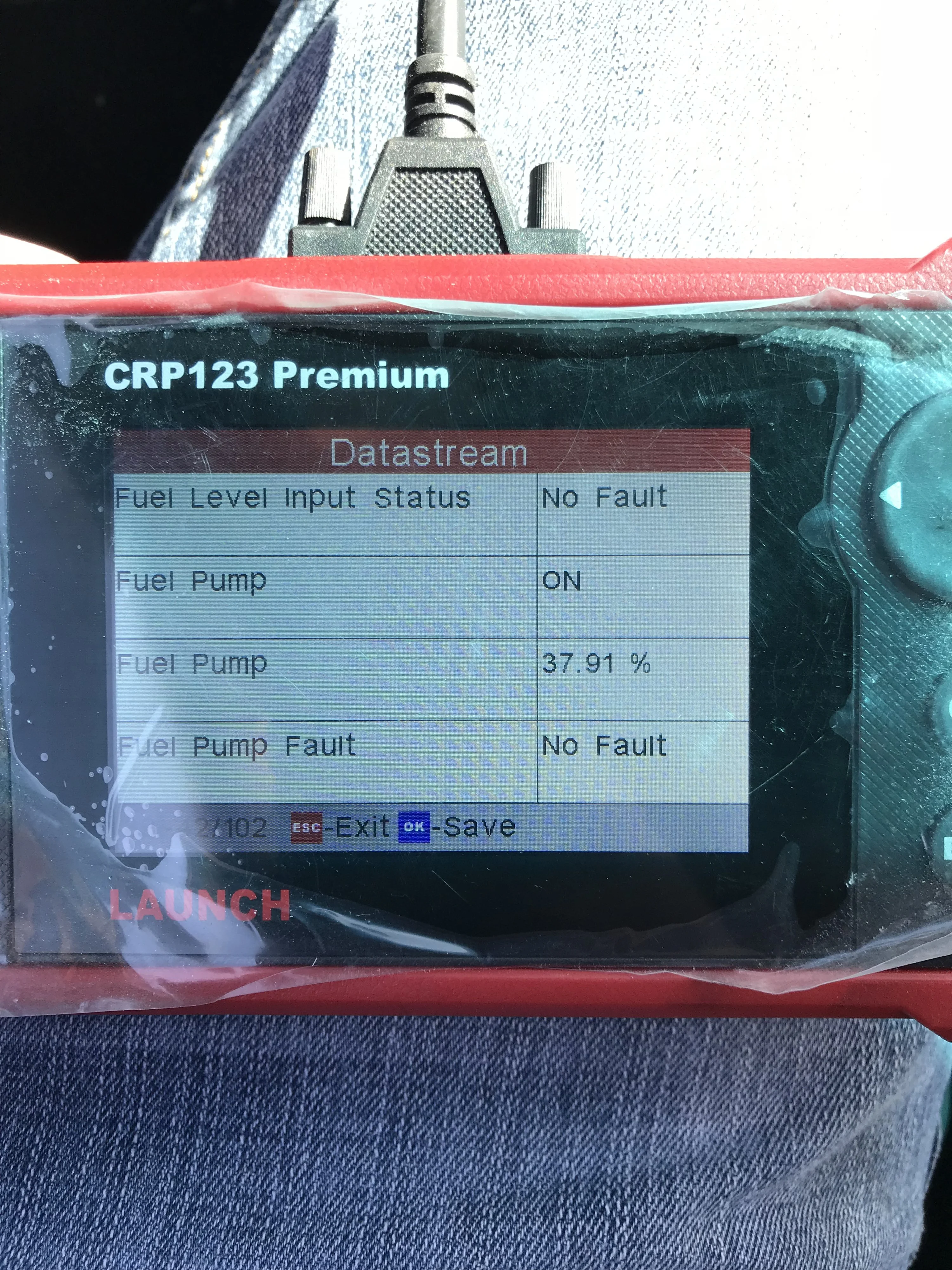

Just an update. I ran a datastream test after I checked for dtcs. No dtcs came up. I failed to mention that when my car ran like :poo:, that I had about 1/8 tank. Haven’t driven it since Tuesday or Wednesday or whenever it was. Hopped in the car today, (with the same amount of gas in it), and it did the same thing. I went and put 10 bucks of gas in it and it ran fine, and I drove it like hell for half an hour trying to duplicate the problem. It didn’t. When I ran the datastream test it said my fuel pump was at 37%. Does that mean it’s on its way out? New fuel pump time? Here’s a pic of the scanner screen. What do you guys think?
A 1999-2004 Mustang uses a return-LESS fuel system. The PCM varies the duty cycle to the fuel pump to vary the fuel pump output to meet demand. It would not be normal for the fuel pump to run flat out except at WOT.
The method you are using to determine the health of the fuel pump is not going to tell IF the fuel pump is bad. The only exception is IF the fuel pump duty cycle is chronically high virtually all the time.
The better method is to monitor the actual fuel pressure. IF the fuel pump is toast it will show up as lower than normal fuel pressure.

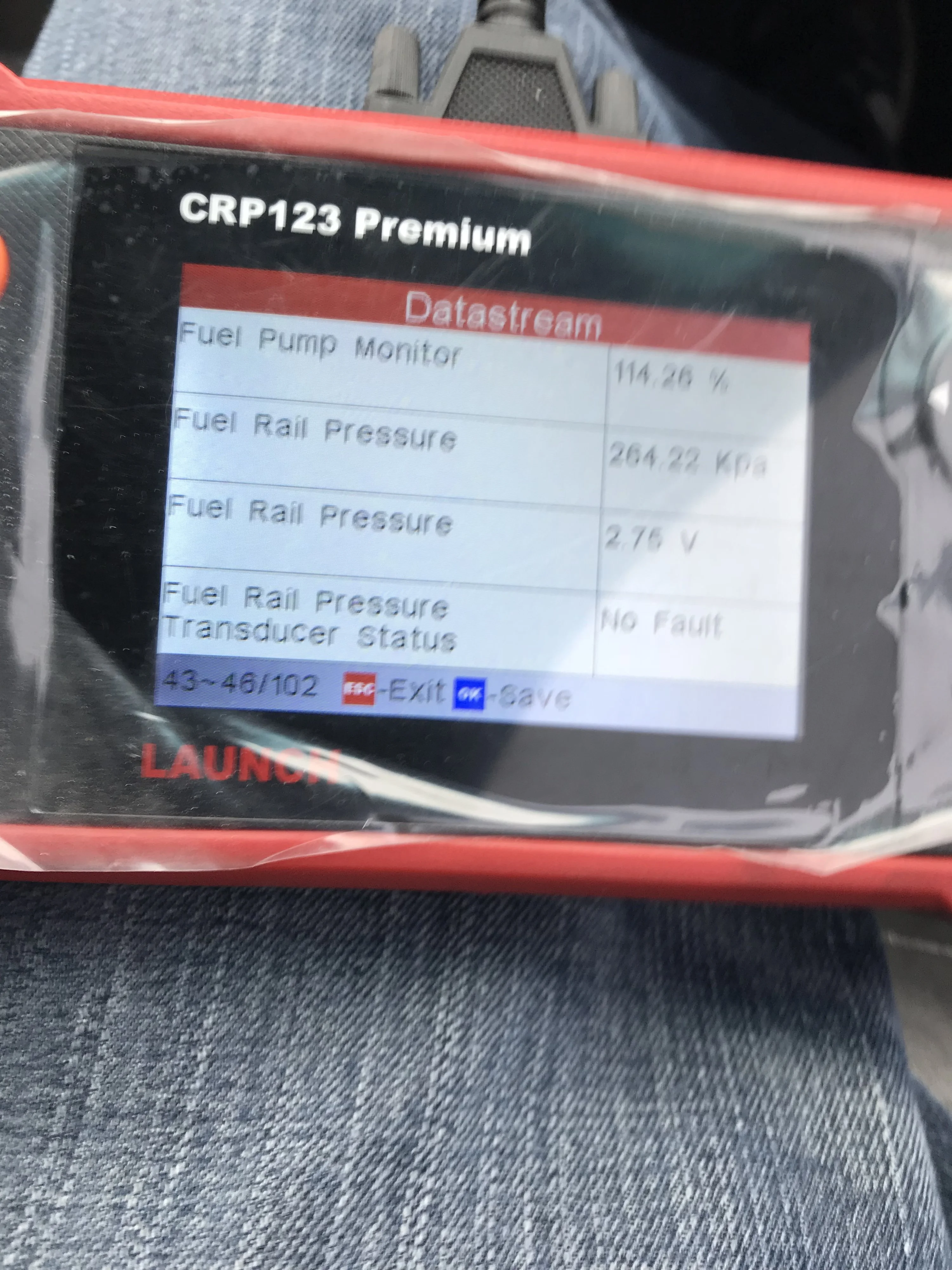

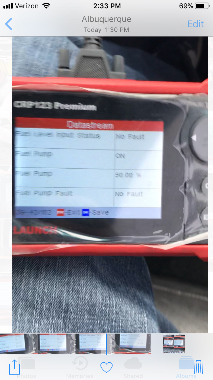

Should I check the fuel pressure at the rails And monitor the pump while I have someone drive it at wot? The scanner has the ability to check fuel rail pressure.
So here’s a couple videos of the fuel pressure and pump, at WOT. The fuel pump percentage at its highest got to 50%. The fuel rail pressure was reading around 263.09kpa, at WOT, 2nd 3rd gear. It’s kinda hard to see, but let me know what you think of the numbers, or if they mean anything to you. Nevermind, the videos won’t load, here’s screen shots of the video.
