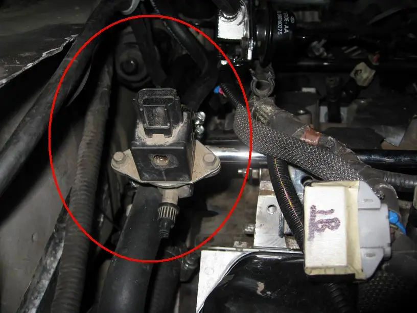

Check the fuel rail pressure sensor. You can pull the vacuum line off and if it squirts fuel at you, then it is bad.
Look toward the firewall on the drivers side.

The Fuel Rail sensor is an easy one. Once you pull the vacuum line you will know it there is a problem.
