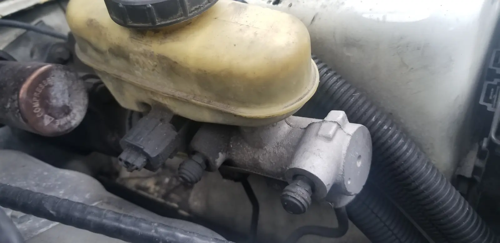

Here's a pic of the master cylinder
Just spoke with a guy at the ford parts and he said that is't because the Hydroboost system used pressure from the power steering pump instead of a vacuum brake boost.
Now...Is there a way to swap hydroboost setup for vacuum brake boost?
No. The reason for the hydroboost is due to the size of the vacuum booster not clearing the big DOHC engine.
