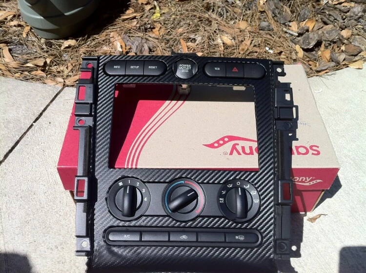

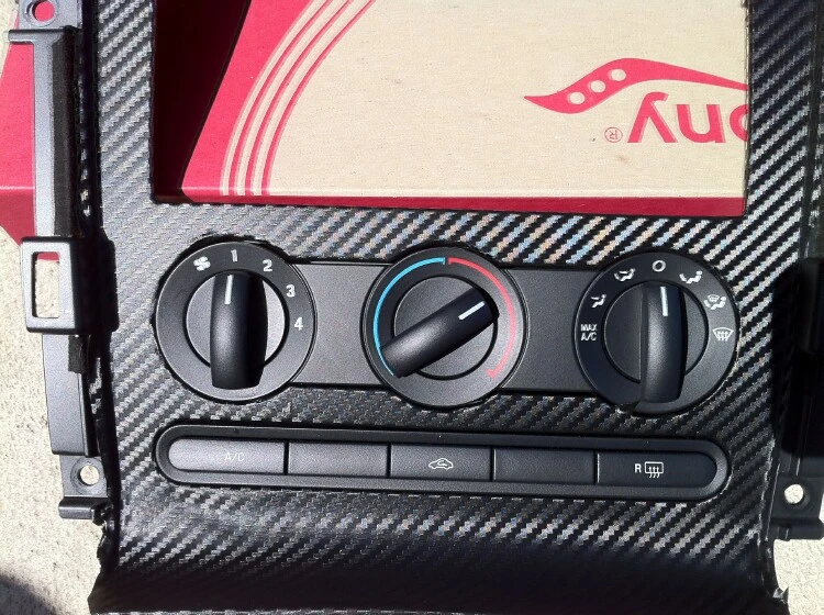

More pictures to follow. While I had the unit apart, I wrapped the trim covers in some carbon fiber vinyl wrap I had laying around. Looks better as a finished product. This picture was the 'in progress' shot.
