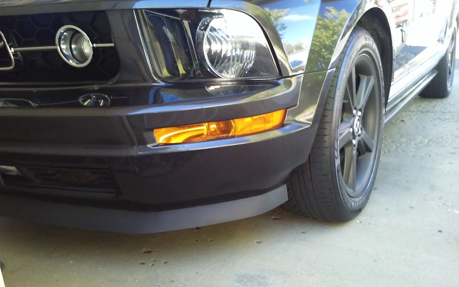

I have an 05 Mustang (base model) with front end collision damage and I need to replace both fenders hood and bumper cover. I am having a hard time finding them for just my basic Mustang. My question is will parts that are for an 05 with a pony package fit?
Red is correct they use the same bumper but the lower and upper grille are different. I have a pony package and I use the driving/fog lights all the time, if you want to make them work you would also need the wiring harness for the lights and the headlight switch that you can pull out to turn them on
