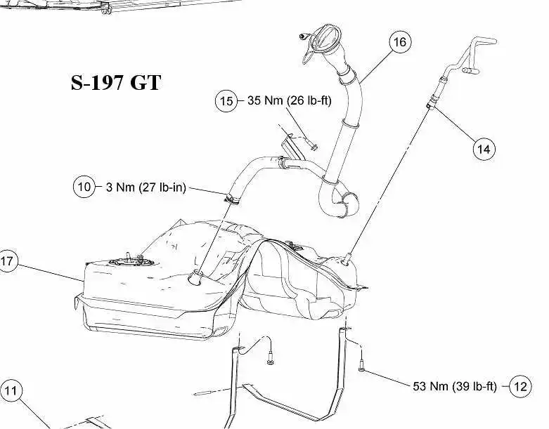

I thought about that, but if you look at the FSM's exploded view, the filler neck is a restrictive rat's maze whereas in most cars the filler neck is somewhat of a STRAIGHT shot into the gas tank. I can see how the filler neck on the GT could quickly fill from a high volume/pressure nozzle and click it off.

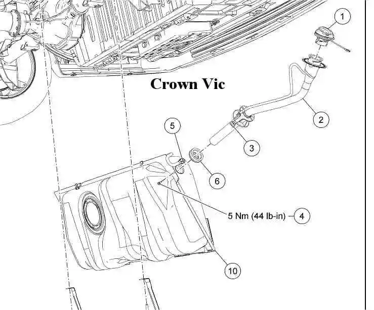

Here's a comparison of the 07 Vic and 07 GT's filler tubes.
The GT filler tube looks like it almost has a trap at the last bend. Coupled with insufficient venting, it could easily fill up and cause the high pressure nozzle to click off. The Vic's filler neck is of a design that is commonly used and less likely to fill up too quickly.
I have not tried to fill up the GT's tank yet, but the first thing I would try is pull the nozzle out a bit more so the filler neck itself could help vent more air from the tank.
Good luck, and short of Ford coming out with a revised filler neck, I don't see any permanent fixes other than trying different gas stations, filling it with the nozzle upside down, or pulling the nozzle out a bit more.

Wow now you mention it, the saddle bag is a really funky design. How do they expect the fuel to flow upwards over the hump to the other side? It's probably a combination of things. I guess it is ironic that the Pony has a saddle bag for a gas tank.
