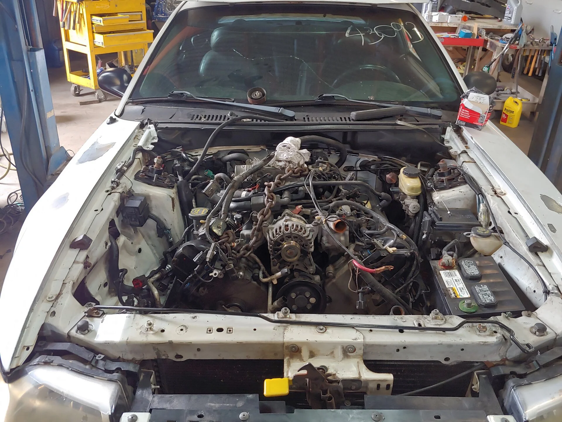

Thank you so much your input was invaluable, and I totally understand what you mean now, I'm using my original intake from the mustang and after reading your previous message I went to the shop to compare what was on the GM engine and the intakes look exactly the same. Everything was swapped over to the GM block and I literally couldn't tell the difference in how it looked compared to the engine we just took out.
Just have to finish sorting out the connections on the harness and you were definitely right when you said the mustang standoffs are better lol. My engine had flexfuel so the rails and injectors were swapped to the new block as well and I was lucky to not have to swap the oil pan because it cleared the kmember so now it's mounted in the bay and we'll be mounting the trans and she should be good to go.
(I know my girl looks rough, we've seen better days lol)
I bought the GM engine with 110k on it, I couldn't pass it up at only $400 from lkq and I'm sure I can get another 75k easy lol (maybe more, I don't drive it hard) and despite the mileage the engine was extremely clean when we popped the valve covers off. (Not that I had any reservations about that, I've purchased engines from them before and never had any issues) I'm just mad I didn't take a pic
