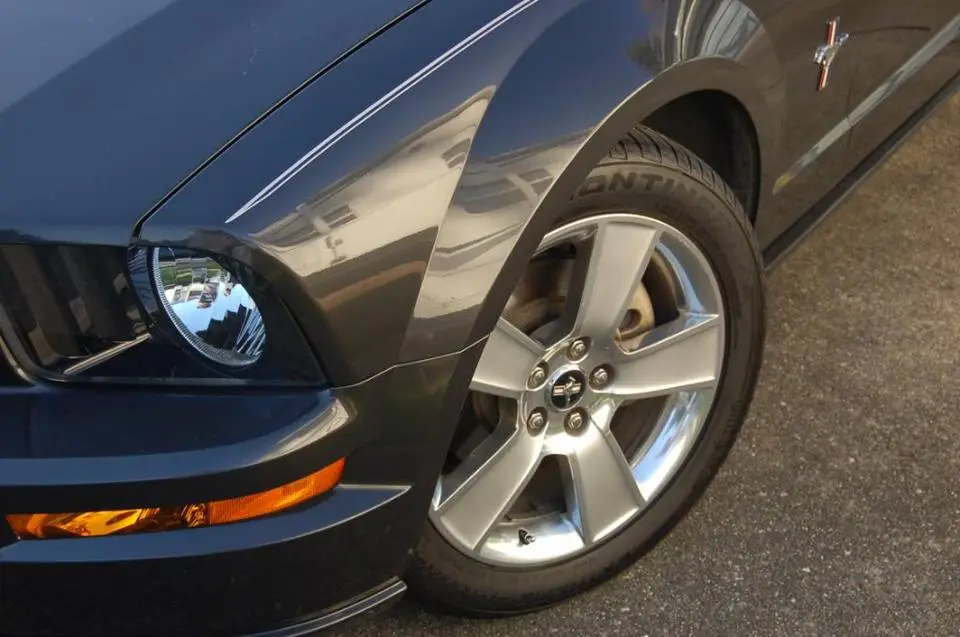

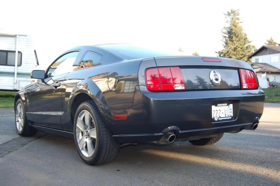

xgto said:
I have, the 18" factory polished CS wheels on my 07 GT. size on them is 235 50 18. Are they wide enough for the 255-45-18's ? And will the wider tire rub in the front ?
thanks
They'll fit perfect. I have the same size wheels (18 x 8.5 factory Fanblades) and have 255/45/18's all the way around with zero issues, but much improved handling (Continental Extreme Contact DWS tires)...
