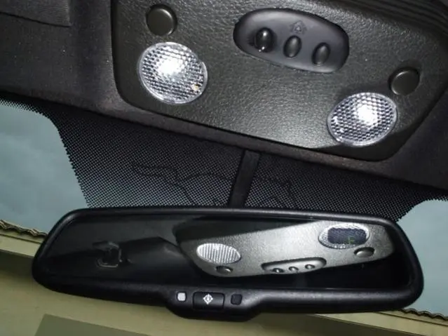

I got a self dimming mirror with compass out of a wrecked Mercury that a buddy of mine had that he was parting out, and I also found a homelink unit out of a Lincoln Town Car sunvisor, total money invested $0.00, easy installed only 2 wires for the homelink unit which I tapped into the wires for the dome lamps, and only 2 wires for the mirror which I ran to the right side kick panel and tapped into a wire that I found that was only hot when key was on.

Just sending a update.
I installed a gentex homelink mirror, with compass, and temp
The install is very easy to do, I think anyone that can work on cars can handle this install.
The hardest part of the install was getting the old mirror off the mounting wedge.
I found a easy way to get the mirror off the wedge with no trouble.
Instructions to get the old mirror off
1: Push mirror up toward the headliner.
2: wedge a small screwdriver in slot between the mounted wedge on the glass, and the mirror mounting connector.
3: user a little force upward on the mirror, while at the same time twisting the screwdriver the mirror mount will slide up and off the wedge very easily.
*Warning do not push the mirror very hard when pushing up, use very slight pressure.
The entire install took about 2 hours, this included wiring, and figuring out how to get the old mirror off.
I am very happy with my mirror upgrade, all features are working perfectly.
