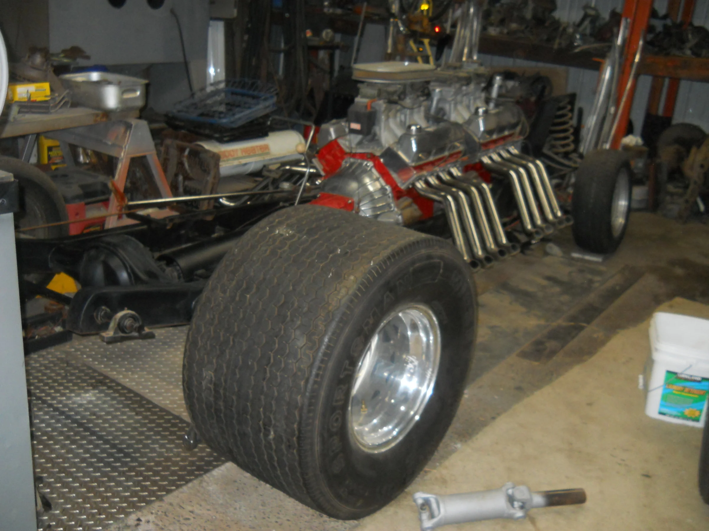

Hey guys, is kinda funny listening to all the tech talk, I used to build my own engine's and raced every weekend. Also built and raced Harleys until I was hit by a drunk, I have several big block engines sitting in my backyard shop, also have few 302's and 351's. I love my Ford engines. Now, at 80, can't do the work I used to and never got to finish some of my best projects but still play with my toys as I can. I have a 89 Saleen with 12,950 orig mi sitting in there, never drive, as I have a cripple left leg and it's a 5 speed. Am not good on this machine but will try to load a pic of my two engine (351C's) 67 fastback. Cheers, Harry

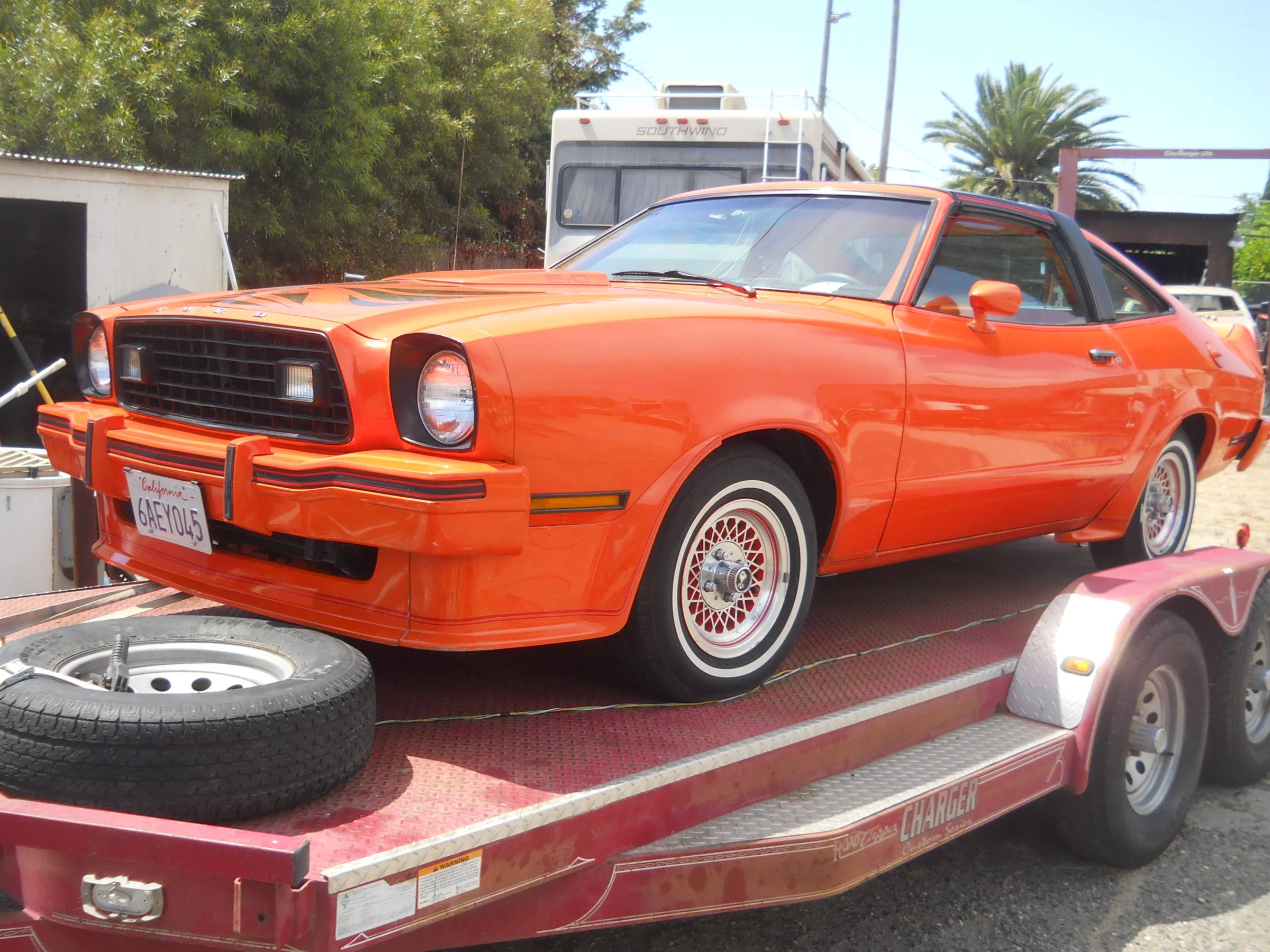

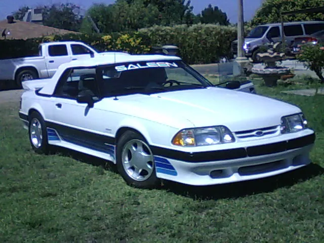

Wow, I can't believe that worked, will send a pic of my KC and my Saleen. Harry

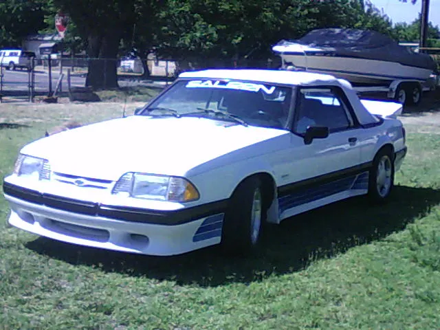

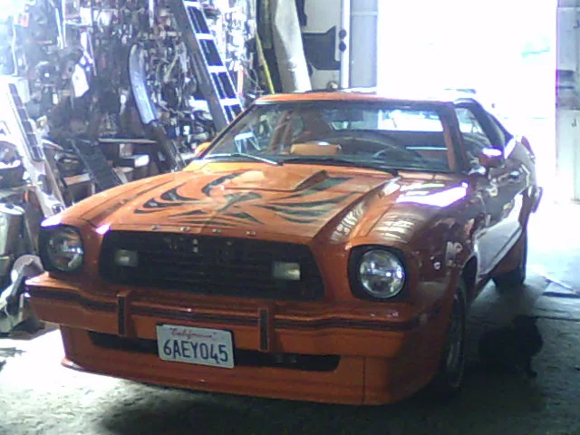

I think something about my camera setting, can't do but a couple pics at a time, Harry
