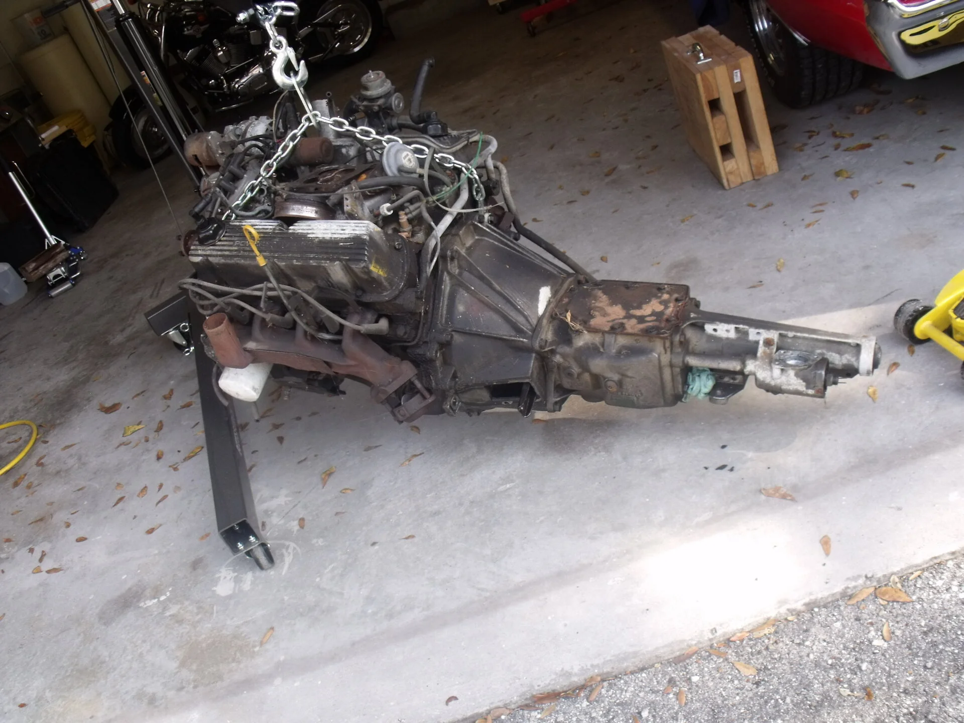

So I finally got the old engine/Trans out of the 83 and partly disassembled.....
10" clutch in it... All I can find with a 26 spline are 10.5 or larger... If I install a Tremec I would like to go with a 26 spline input .. I assume others on here have fought this battle...
