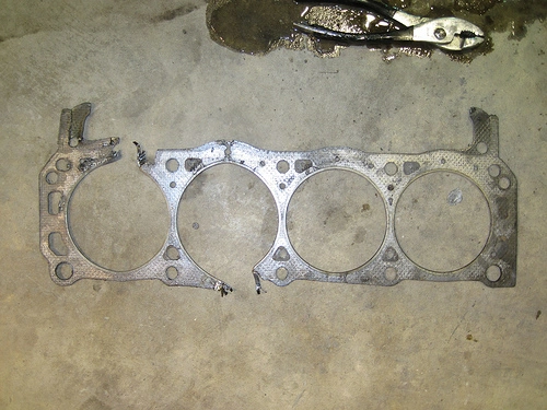

Finally found a good spot with my ET Streets at 15psi. Left at 1500rpm off the footbrake to a 1.65 60ft. Car went 11.01 @ 127.65, had just a split second of detonation before the traps, enough to ream out the 8548-PT2 gaskets but heads/block/pistons look perfect. No signs of detonation on them. Two plugs had the electrode slightly eaten away.

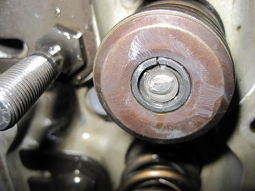

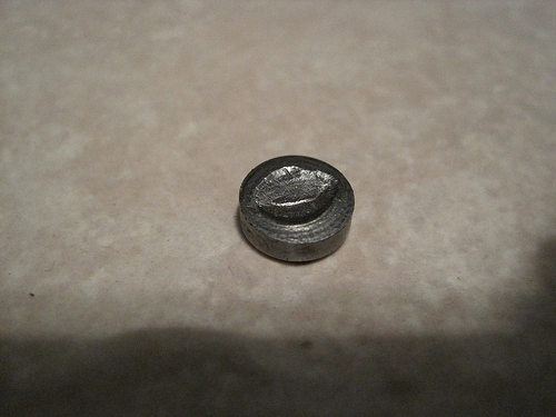

Thanks guys, found a little more carnage tonite. Not related to the head gasket though but it delayed me getting the car running and back on the dyno tonite.
Will be putting a new valve in it tomorrow. The welded tip just came off... inexpensive valves in the Trickflow head.

No damage. It was under the rocker arm.
Here it is:

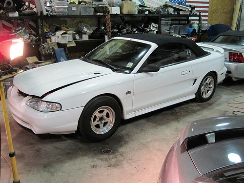

Here she sits...

you know i think thats first pic i've ever seen of your car Wes....
sucks that it had to go on you right when your nearing the end of the block but at least its nothing serious.
