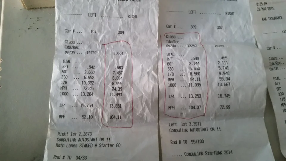

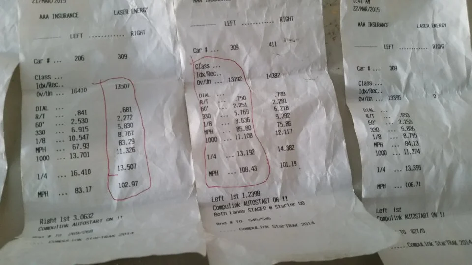

So only making it to one track night so far, I plan on making it down next week to see how it does. Based on my posted timeslips, what should my average 60ft be based on trap speed? My friends say they're horrible, but on street tires I pretty much have to leave from 1500 with a slight bog launch to not spin 1st off. To me it runs excellent for a daily and being put together with whatever cheap parts I could scoop up. I'll be taking my radials this venture in hopes of getting some better times, wouldnt mind some input of what it may run beforehand though. 3200 pound car loaded, 5 speed with 3.55's.

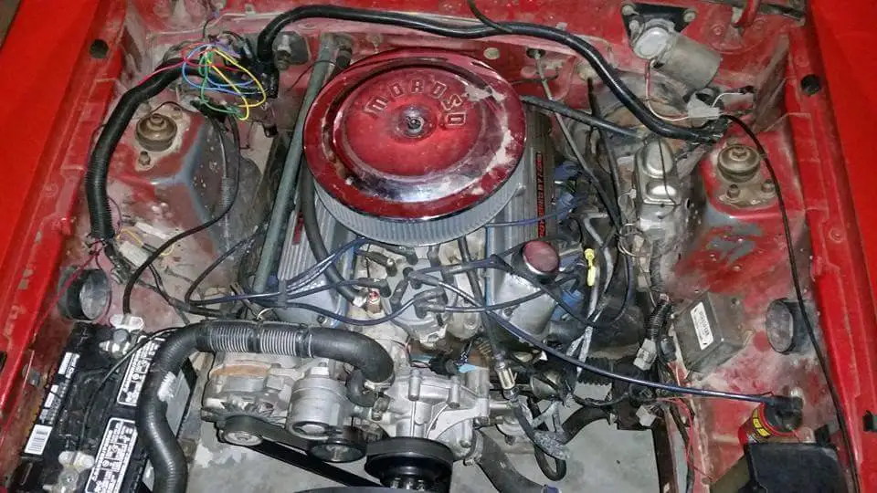

My setup is an 91 shortblock, gt40p heads with new valves and springs, tfs stage 1 cam, proform 1.6's, performer 2 intake, and a
holley 600 vac sec/600 dp.

what is up with mph?
103, 108, 107, 104, 104...
with a decent DOT tire, 103/104 should be good for 12.8-9's, 107/108 should be good for 12.6-7's assuming the car is set up for street, not strip only.
throw slicks on it and those times could improve, especially with a gear change... throw drag radials on it and consistency will likely be rather difficult with 3.55's and a stick trans.
