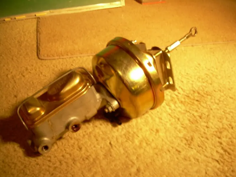

my front brakes will not hold the car, if im doing a line lock assisted burnout or they wont even lock up when i totally slam on the brakes from 50mph. im almost positive my master cylinder isnt big enough to push the big calipers. being a 65 coupe, clearance is a BIG problem and i cannot find another master that is small enough to put in there. i currently have a booster in there and my question is, could i go with a non power master that has a larger bore to solve my problem? is the booster needed?

No, a larger bore will make it worse. What booster do you have? If it's one of the "modern conversion" types, straight line, like this:
They suck and everybody I know who has used them has had problems. I know where there's a couple of brand new ones lying on the floor in a shop, where they were yanked off and thrown in disgust.
The only one that seems to work well on 64-66 cars is the replica of the original, which comes with single or dual master. It also has the advantage that it works with stock clutch linkage:

I think you want something with a smaller bore. Smaller bore = more pedal travel but less effort.

The statements about the bore size are correct. A smaller bore is what it sounds like you need.
Before you go and replace it make sure that there is not something else that is wrong and that the system if properly bled of air.

ya mine looks like the top one and its a super tight fit.

Nothing, in theory. Frequent defects, in practice. They tend to be too sensitive, due to the short leverage of the standard pedal, and they often end up with too much pedal travel due to the leverage. This means that even a minor variation in function makes them work lousy.
The stock type reduces the leverage, allowing better "feel", in 65-66 with the bracket and lever on the booster, and with a longer pedal on 67-70.
