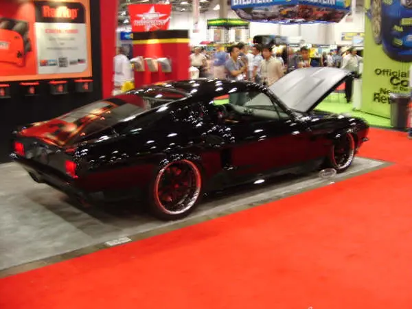

i say do the 18's,be different,thats the "in thing" right now.My buddy had 16" on his car in 88' and people thought he was crazy.I had one of the first sets of 17's in 94' and people just shook their head
