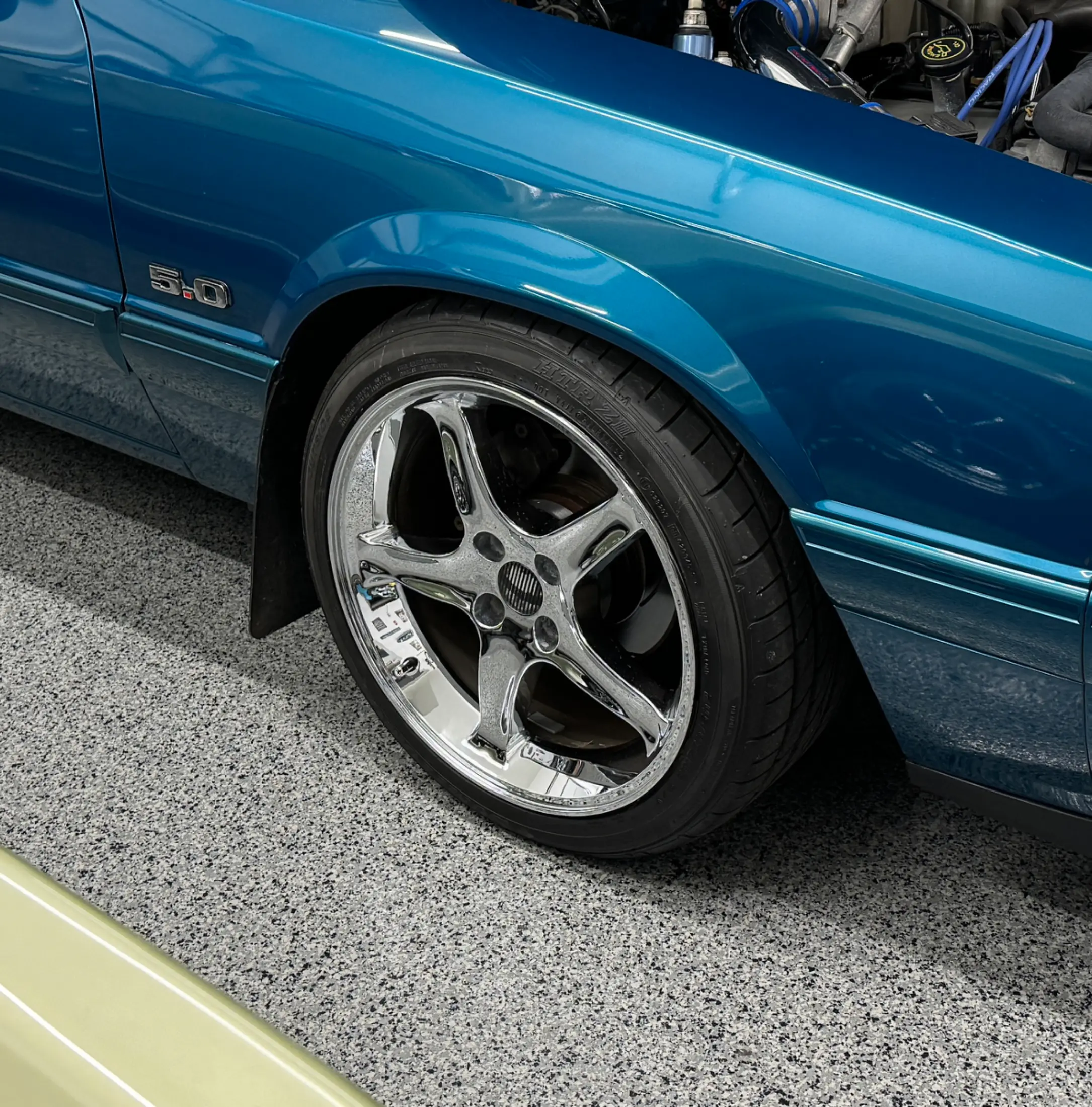

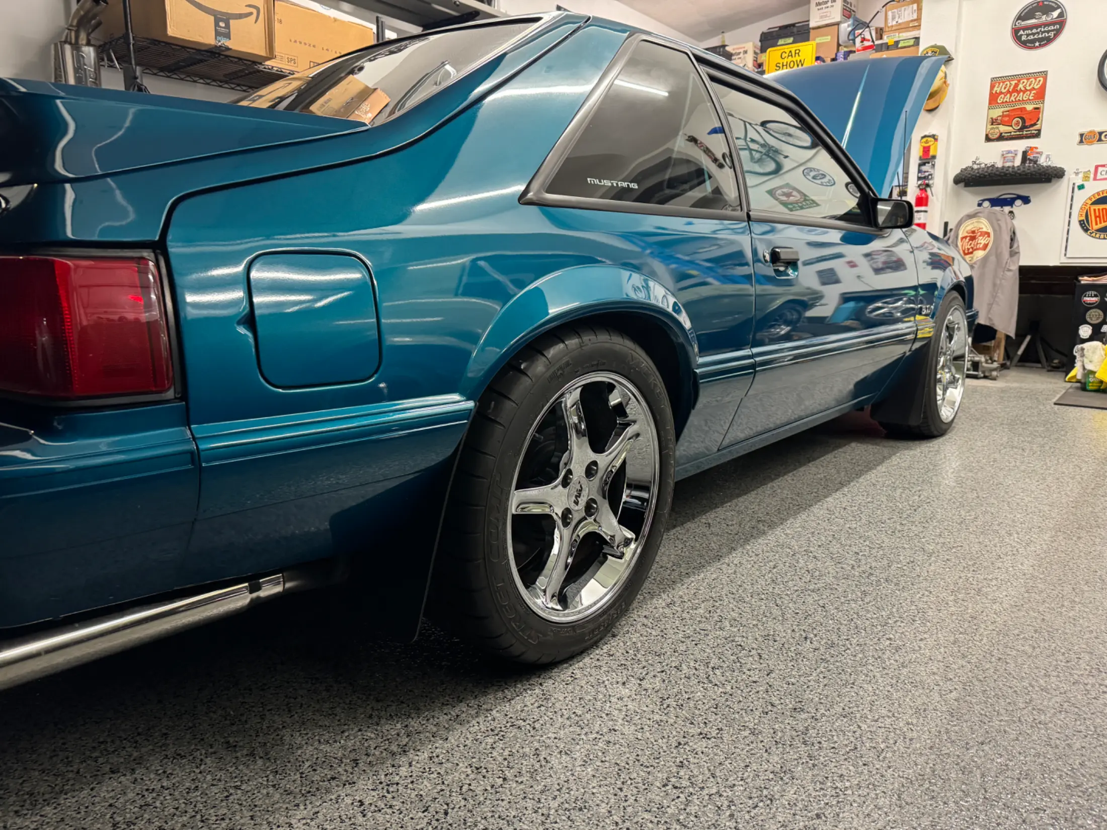

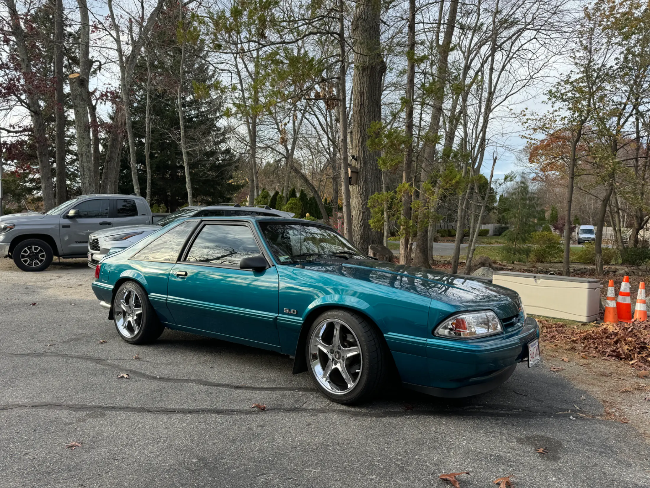

My 93 came with 18x10’s squared and 235/40/18 tires. That tire is definitely too narrow for a 10” wheel so when I replaced I went with 245/40/18 which filled out better but still not great. I could go wider in the back but not the front.

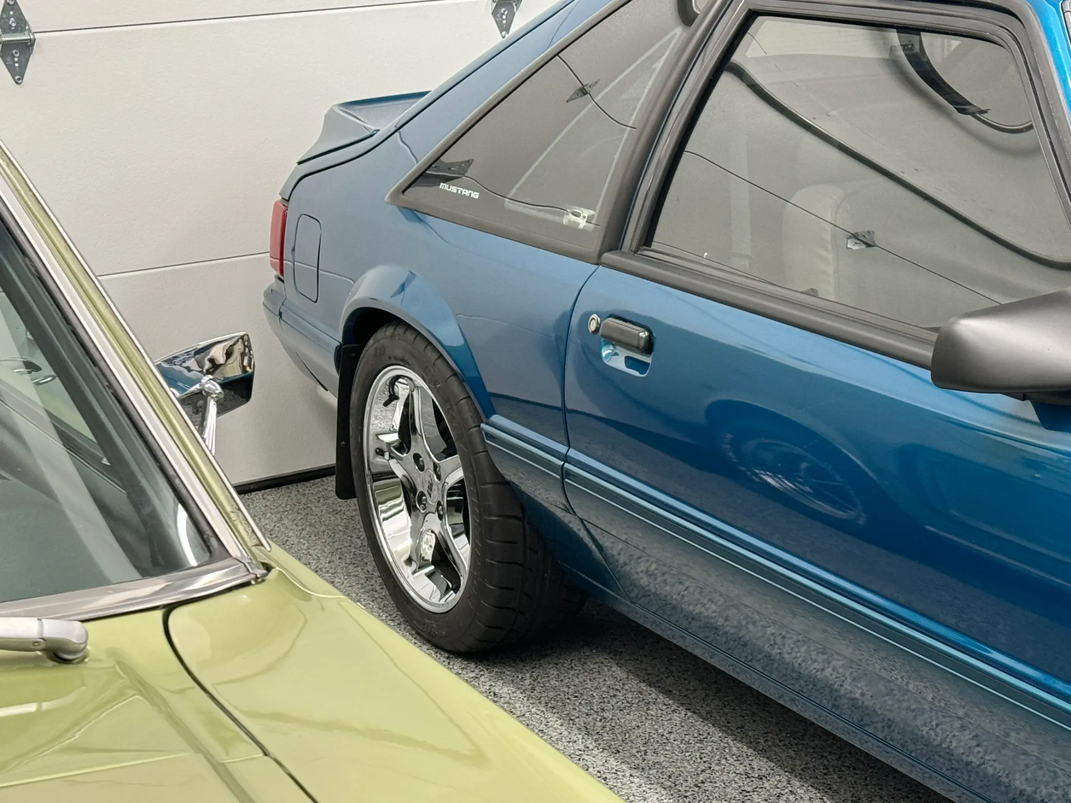

I picked up a set of 17’s with 245/45/17 tires. Pretty standard I guess. I honestly don’t like the look of the giant sidewall but I’m also used to the low profile. (See rear wheel pic)
The odd thing is my 18’s are 4 x 108 which I can’t find any 4 lug 18’s on line. Do they exist anymore??
I’m not doing a 5 lug conversion at this point. I wouldn’t mind picking up two 18x9’s for the front to match my current rims then go staggered.

Yeah it might be because I’m use to the 18’s. The 17’s I have are 245/45/17. Maybe 245/40 would look better. Side walls seem too much.
245/45/17 is the proper tire size for a 17" wheel that maintains the proper 25.7" OD of the tire. If you start going smaller (245/40/17 is 25.0") you run into issues of the fender gap increasing which makes you want to lower the car more.
A quick question - how did you come up with the sizing of your rims? Was it stamped on the back side of the rim, or did you measure the width? If measured, where did you measure from and to?
The reason I ask is looking at your pictures with the 245 tires on (I assume that is what is on them in the pics) the rims don't look 10" wide relative to the tires. They look smaller. If you measured outside of rim lip to outside of rim lip, that is not the rim width, you should subtract 1-1.5" off that measurement. Rim width is measured where the bead of the tire touches the rim, so inside of lip.
My 18x9s will be just over 10" to outside of lip. You can see that my 255s are not flush with the rim face. If you have 245s on 10" wide, your tires should be leaning back worse than this.

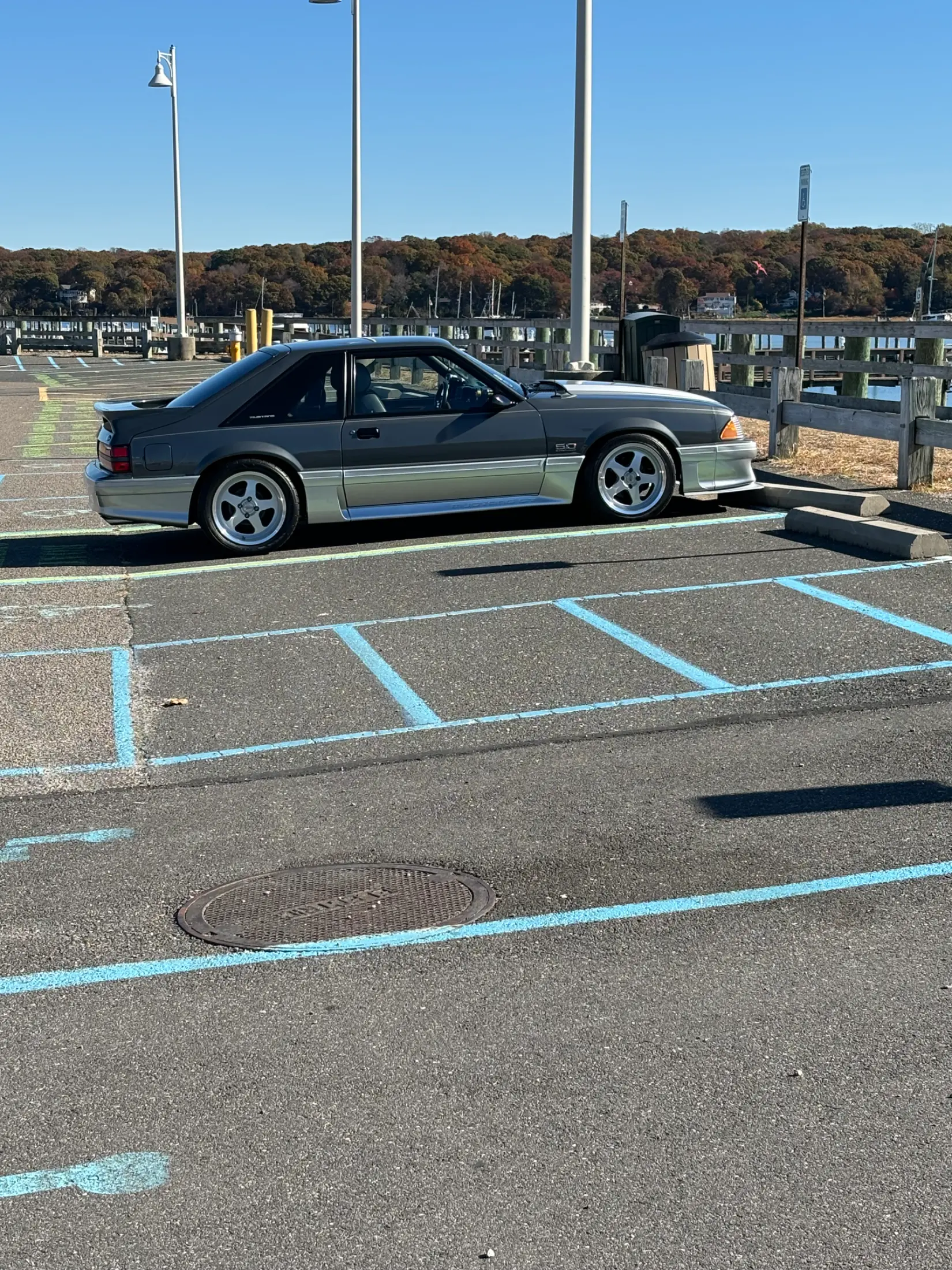

Looks good! What size rubber and are those 9” wheels?

The rears are 17x9 in the picture (I had one of each on the see the difference. The fronts are 18x10. The outside picture of car has 18’s all around. I measured outside of rim to outside of rim. Plus I think they were stamped on the inside.

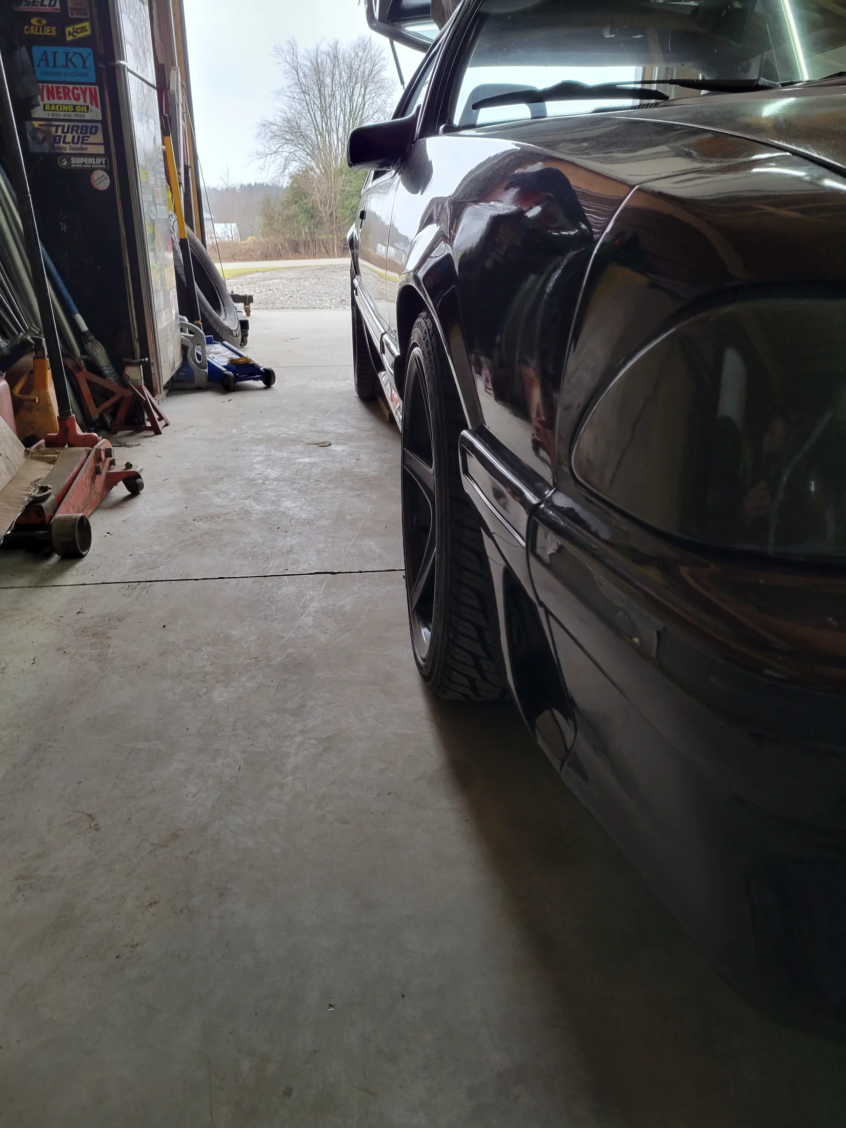

The fronts are 17x9 and the rears are 17x10. Rear rubber is 315/35/17 and the fronts are 255/40/17. To get the rears to fit and not rub was tricky.
First I had to use longer ARP wheel studs. Then, a 1/2" Baer spacer. I think it's 1/2". Bilstein quad shocks because they are narrower. I have LX exhaust on the car with the Cobra rear valance. When I tell you it clears by a 1/4", it clears by a 1/4". I've had this set up for years. I love it. Car makes a little over 500hp at the crank, so I need every little bit of that 315.
