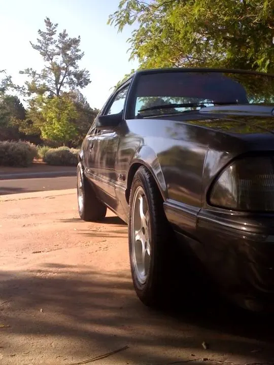

Well, this is a 235/45/17 on a 8" wide rim
So take away a 1/2" from front and rear and judge for yourself how a 235 might be on a 7" wide wheel
:shrug:
attachment.php
stock diameter is 25.7"
A 225/45/17 is 25.0"
A 235/45/17 is 25.3"
Your call really
:shrug:
attachment.php
Your call really
probably pretty close to what i want! i would've kicked myself if i got another set of tires that looked "stretched".
