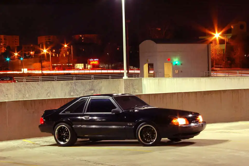

17X9 up front and 18X10 in the rear...pics?
Here you go.I saved the info on his car because I was thinking about doing the same thing.
17x9 245/40 summitomo's 94/95 spindles, upr kmember/aarms/coil overs, mach 1 brakes with fms slotted/drilled rotors
18x10 275/40 summitomo' ranger axles, north race cars brakets, cobra brakes with fms slotted/drilled rotors. eibach springs, factory 5 control arms
http://i637.photobucket.com/albums/uu96/chucknutz2/rake.jpg
This is the car i was talking about! I love it!

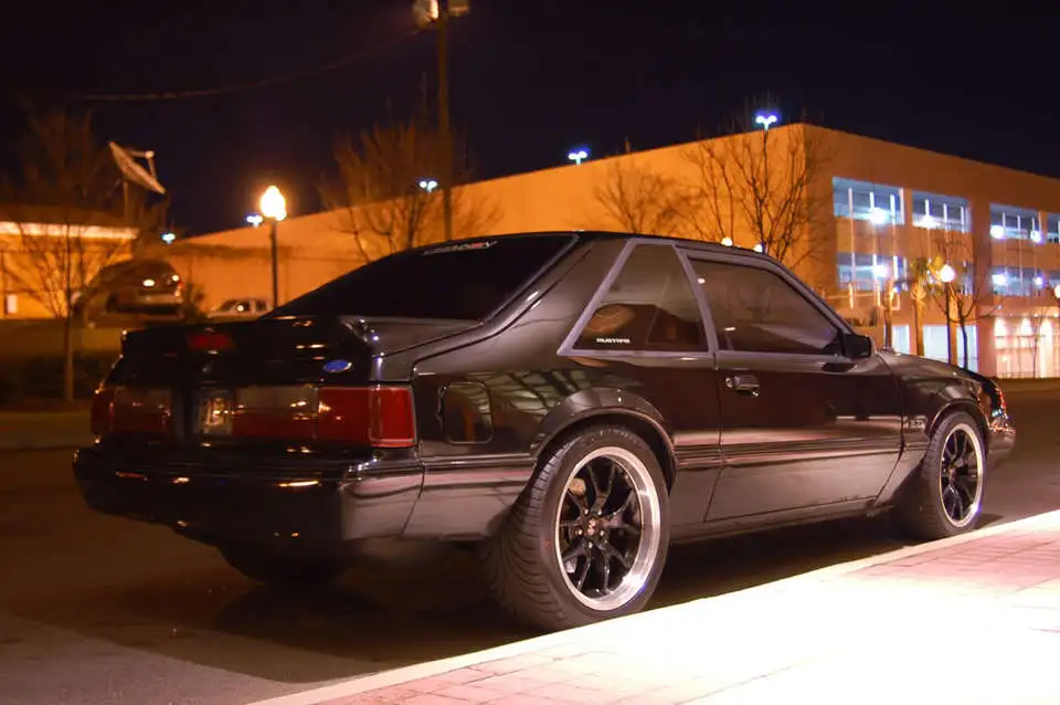

Why go 18X9 in the rear? Its easy to fit a 10" wheel, plus the 18X9 are not available with a deep dish.
I think I could get 18X10's +40mm offset in there with the 94-98 axle. It will be VERY close. They have 7" of backspacing. Hack Job had the 99-04 axle with 17X9's +45mm offset and 6.8" of backspacing. PLENTY of room behind the wheel, but they were right out to the edge. idk what 18X10's will look like exactly.
I was under the impression they make 18x9 deep dish wheels now.
Kabukinotch I believe his name was had a set of black Bullitts in 18x9 with a lip on them.
I think a 285/40/18 would fit nicely, along with the 275/40/17 front.
I'd have to look. I thought they did as well. So many sites. I am buying from AM because of free shipping and multiple different offsets so I can mix and match.
