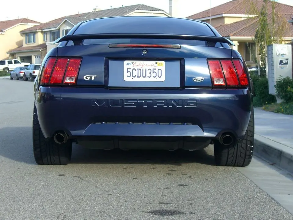

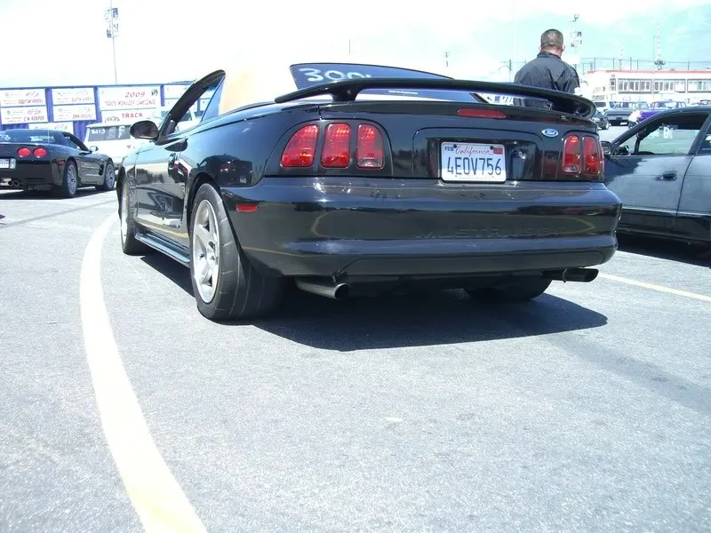

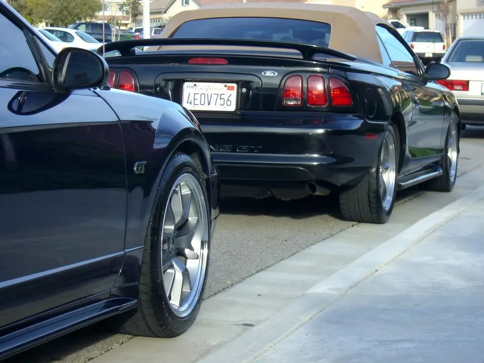

285/35 x 18 is good in the back...along with 295/35 x 18
in the front i run 245/40 x 18
and since someone talked about the track and tenths of a second or whatever.....if you do go to the track....Get drag radials....perferably something like this... 315/35 x 17 Micky Thompsons.... street tires suck ass if you have mods. My 98 is pi swapped, bolt on's with tune...and i think theres still a little bit of spin when i launch at 4k rpm.
