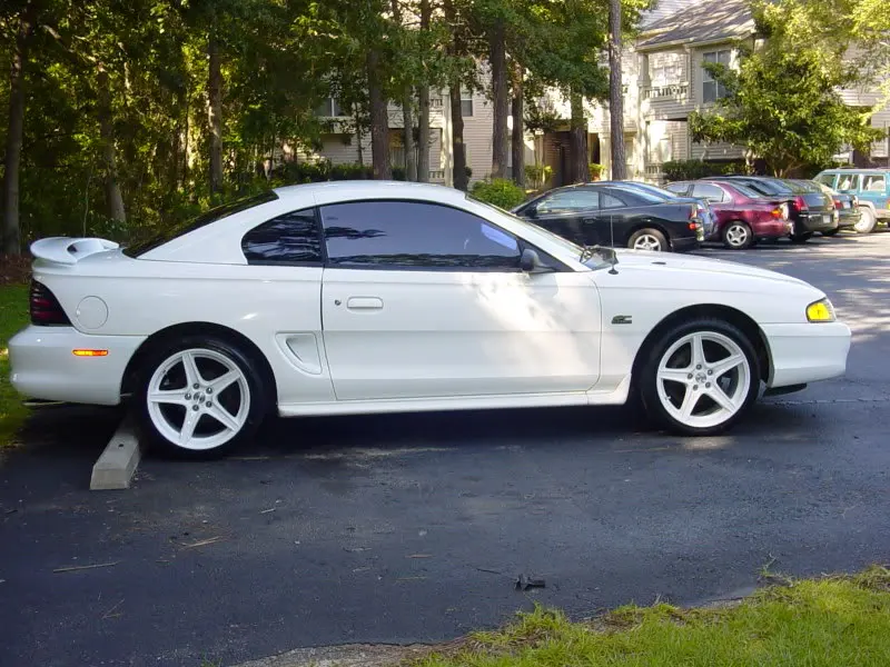

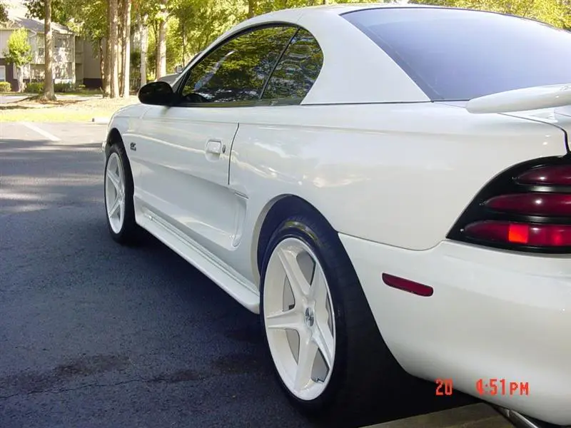

I'd stay away from a 245 on a 9" wheel. I have them, and the lip sticks out farther than the sidewall. I very lightly rashed one of my front wheels not realizing how close I was to a curb when I pulled into a parking spot. The rear would've been alright. Go 255 or 265 on the front if you use a 9" wheel. Here's a few pics to show what I mean. The front is a 245/40/18 and the rears are 285/35/18.
