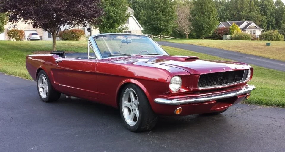

Awesome, I was just about to make the same post but I'm glad you beat me to it and have tested it already. I wanted to go with the 563Rs but apparently they don't make them anymore so I need to find another set. Also, they'll be attached to Baer Pro + brakes and TCP coilovers so I'm excited for the change, but man I won't be able to buy anything else for awhile. Do you have any pics and how lowered is your car?
The pic below is a bit old, but you get the idea. I did the Shelby drop in the front and 1" lowering springs and 1.5" lowering blocks in the rear. Once I get the wheels/tires on and make sure everything fits nice, I'd like to go another 1" all around.

Nice, looks great. Don't you get any rubbing with the fenders though with the wheel turned? I really want the protouring look but I'm afraid 8" wheels are too narrow, but I don't have the money to mini tub and I don't want to go to a Mustang II front end and remove the shock towers just yet.
